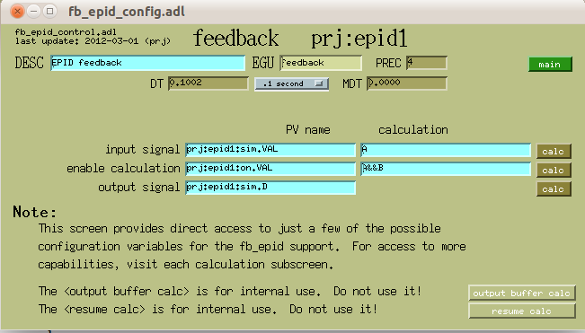

3.1.3   fb_epid configuration screen
The configuration screen provides top-level access to the main components that must be addressed for basic configuration. Note that advanced situations must use the calculation screens to access the complete interfaces of the swait records.
``fb_epid`` configuration screen
Figure: fb_epid configuration screen
Caution!
The buttons marked output buffer calc and resume calc in the lower right corner are for internal use only. Do not change anything on these screens.

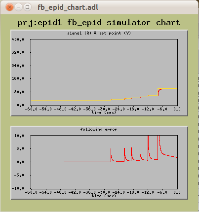

3.1.4   fb_epid chart screen
The chart screen provides a view to the recent progress. There are two strip charts (value v. time). The upper chart shows the set point (.VAL) and current value (.CVAL). The lower chart shows the following error (.ERR).
Note
The limits on the two charts need to be set before this screen is of any real use. Right-click and select "PV limits" from the pop-up menu. Don't forget to apply any changes.
``fb_epid`` chart screen

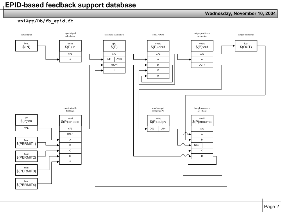

4.1   Structure of the EPICS Database
The EPICS database was constructed in 2004. The records of the database are defined in this table:
record type name description
epid $(P) Epid record instance
swait $(P):in Input signal collector
swait $(P):obuf Enforces $(P).FBON to disconnect epid record from output so $(OUT) is not changed
swait $(P):out Output signal collector
sseq $(P):outpv Part of bumpless start feature
swait $(P):resume Part of bumpless start feature
bo $(P):on User switch to turn epid ON or OFF
swait $(P):enable Automatic ON/OFF feature
swait $(P):sim Simulated temperature reading and heater
A figure was produced to show how these records are connected. Note that the simulator record ($(P):sim)is not shown in this figure.
structure of fb_epid database
Figure: Structure of the fb_epid database
The database file has many comments. The text of the file is included here:

# For each channel:
#  signal(ao or other)
#    -> in(swait)
#    --> epid
#    ---> obuf(swait)
#    ----> out(swait)
#    -----> positioner(motor or ao)

grecord(epid, "$(P)") {
        field(DESC, "EPID feedback")
        field(INP,  "$(P):in")

   # Input calculation to the epid record
   # Users can adjust the input based on a simple calculation
   # or a more complex database resulting in this simple calculation
   # By default, $(P):in.INAN is the PV name of the input signal
grecord(swait, "$(P):in") {
        field(DESC, "EPID feedback input")
        field(PREC, "5")
        field(SCAN, "I/O Intr")
        field(CALC, "A")
        field(INAN, "$(IN)")
        field(INAP, "1")
   # Output buffer from epid record
   # This record overcomes a limitation observed in the
   # epid record when $(P).FBON=0 but $(P).OVAL is changed anyway.
   # In this record, $(P):obuf.VAL will not change when $(P).FBON=0
grecord(swait, "$(P):obuf") {
        field(DESC, "EPID FBON output buffer")
        field(PREC, "5")
        field(CALC, "B?A:C")
        field(INAN, "$(P).OVAL")
        field(INAP, "1")
        field(INBN, "$(P).FBON")
        field(INBP, "1")
        field(INCN, "$(P):obuf.VAL")
        field(INCP, "1")
   # Provide the output from the epid record (through the output buffer)

   # bumpless start feature
   # When $(P).FBON transitions from 0 to 1 (as feedback starts up),
   # it is necessary to grab the current value of the
   # output positioner and push it into $(P).I
   # However, since the user might change $(P):out.OUTN,
   # $(P):outpv detects this change and rewrites $(P):resume.INBN.
   # $(P):resume.INBN holds the PV name of the output positioner
grecord(sseq, "$(P):outpv") {
        field(DESC, "follow OUT PV name")
        field(DOL1, "$(P):out.OUTN")
        field(DLY1, "0")
        field(LNK1, "$(P):resume.INBN")
grecord(swait, "$(P):resume") {
        field(PREC, "5")
        field(CALC, "!C&&D?B:A")
        field(INAN, "$(P):resume.VAL")
        field(INAP, "1")
        field(INBN, "$(OUT)")
        field(INBP, "1")
        field(INCN, "$(P):resume.D")
        field(INCP, "0")
        field(INDN, "$(P).FBON")
        field(INDP, "1")
        field(OOPT, "On Change")
        field(OUTN, "$(P).I")

# simulate a temperature sensor and heater
# A : minimum "temperature" allowed
# B : cooling rate parameter
# C : heater power
# D : output of PID loop
# E : heater relay closes when D > E
# F : current "temperature"
# PID loop terms:
#   $(P):in.INAN = "$(P):sim"
#   $(P):out.OUTN = "$(P):sim.D"
#   $(P):enable.INAN = "$(P):on.VAL"
#   $(P).KP = "0.01"
#   $(P).KI = "0.1"
#   $(P).I = "0.0"
#   $(P).KD = "0.0"
#   $(P).DRVL = "0.0"
#   $(P).DRVH = "1.0"
#   $(P).FMOD = "PID"
grecord(swait, "$(P):sim") {
        field(DESC, "EPID Temperature Controller simulator")
        field(PREC, "5")
        field(SCAN, ".1 second")
        field(CALC, "max(A,F*(1-B)+C*D*G)")
        field(A,    "0.1")      # minimum "temperature"
        field(B,    "0.05")     # cooling rate parameter
        field(C,    "30")       # heater power
        field(D,    "0")        # driven by epid loop
        field(E,    "0.8")      # relay close threshold
        field(INFN, "$(P):sim.VAL")
        field(INGN, "$(P).FBON")# is feedback ON?
4.2   Simulator
To help learn how to use the fb_epid support, an swait record was added to simulate the temperature reading of an object that is exposed to some cooling power. A heater with adjustable power may applied, either as adjustable power or as a switched power.
Documentation of the simulator is provided on a related page.
