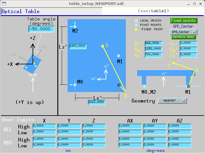

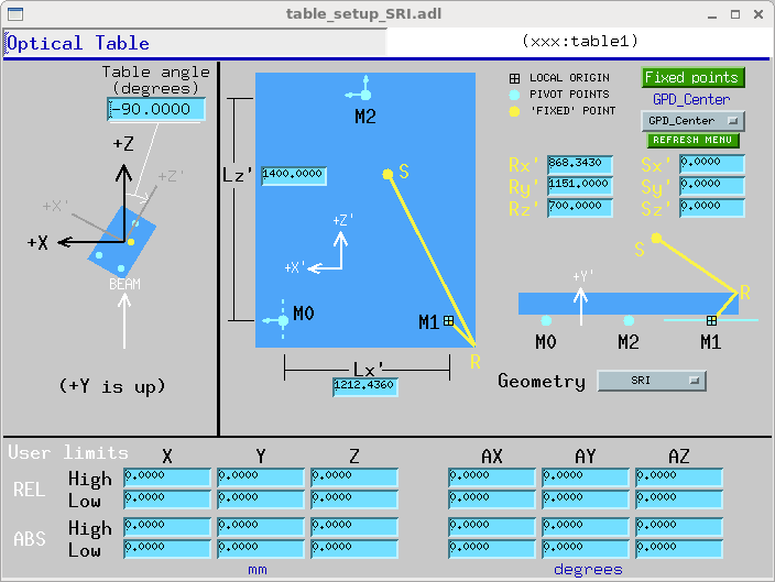

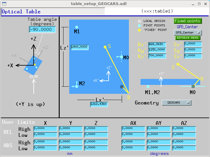

The table record controls six (or fewer) motors that drive an optical table, a platform that generally can move in three orthogonal directions (X, Y, and Z), and rotate about the X, Y, and Z axes by angles AX, AY, and AZ. The record allows users to specify the point about which rotations are to occur--this is called the "fixed point" in the figures below.
The record assumes the platform rests on three pivot points named M0,
M1, and M2. (See Figs. 1-4, below). The locations of these pivot points,
and the manner in which they move, is specified by the field GEOM (loosely,
the table geometry). Four geometries, named SRI, PNC, GEOCARS, and NEWPORT,
are supported by this version of the table record.
Figure 1 (SRI geometry)
Figure 2 (PNC geometry)
Figure 3 (GEOCARS geometry)
Figure 4 (NEWPORT geometry)
In the SRI, PNC, and GEOCARS geometries, three motors (M0Y, M1Y, M2Y) move M0, M1, and M2 in the Y direction (vertically); one motor (M0X) moves M0 in the X direction; one motor (M2X) moves M2 in the X direction; and one motor (M2Z) moves M2 in the Z direction. M1 is unconstrained in the X-Z plane; M0 is unconstrained along the Z axis.
In the NEWPORT geometry, the three motors (M0Y, M1Y, M2Y) vary the lengths of the table legs (i.e., the distances between the table top and pivot points M0, M1, and M2). Thus, in this geometry the pivot points do not move vertically.
You are (or the instrument specialist is) expected to customize the table software by specifying the motors it is to control, and to set up the table by describing the locations of the pivot points, and by specifying the table geometry, the orientation angle of the table with respect to the laboratory coordinate system, the location of the point about which the table is to rotate (also called the "fixed" point in this documentation), and any absolute user limits on virtual motors.
In this version, the location is specified by two vectors: a reference-point vector R, which locates an arbitrary point from which measurements are practical (e.g., a corner of the table surface); and the vector, S, which locates the fixed point relative to R. These vectors are specified with the fields RX, RY, RZ, SX, SY, SZ. They are defined relative to the origin of the table's local coordinate system. (See Figs. 1-4.)
If R=0, the new system is nearly identical to the old, except for the value SX, whose definition has changed such that SX_new = LX - SX_old. (In most cases, SX_old was equal to LX/2, so no change is required.)

Specify the locations of the pivot points (legs).
Select a table geometry by setting the field GEOM to "SRI", "GEOCARS", "NEWPORT", or "PNC".
SRI geometry
GEOCARS geometry
NEWPORT geometry
PNC geometry
Specify the orientation of the table with respect to the laboratory coordinate system.
The table orientation is specified with YANG, the angle through which the table must be rotated from an arbitrarily chosen "standard" position to the position in which you are going to use it. For the SRI and PNC geometries, when YANG=0, M2 is downstream. For the GEOCARS geometry, when YANG=0, M1 is directly downstream from M2. For the NEWPORT geometry, when YANG=0, M2 is directly downstream from M0. As the table rotates clockwise (as seen from above) YANG increases. (These standard positions are illustrated in Figs. 1-4.)
Specify the point about which the table is to rotate.
This point is specified by (RZ, RY, RZ) and (SX, SY, SZ), as shown in Figs. 1-3, above.

MEDM DISPLAY FILES
files to be placed in <top>/<app>App/op/adl/ |
table.adl | Small control display |
table_setup_SRI.adl | Setup display for SRI geometry |
table_setup_GEOCARS.adl | Setup display for GEOCARS geometry |
table_setup_NEWPORT.adl | Setup display for NEWPORT geometry |
table_setup_PNC.adl | Setup display for PNC geometry |
table_full.adl | Full control display |
These files build medm screens to access the table
record. To use one of them from the command line, type, for example
medm -x -macro "P=xxx:,Q=Table1,T=table1,M0X=m1,M0Y=m2,M1Y=m3,M2X=m4,M2Y=m5,M2Z=m6" table.adlwhere xxx:table1 is the name of the table record, and xxx:Table1: is the prefix attached to all other records in the table database. |
