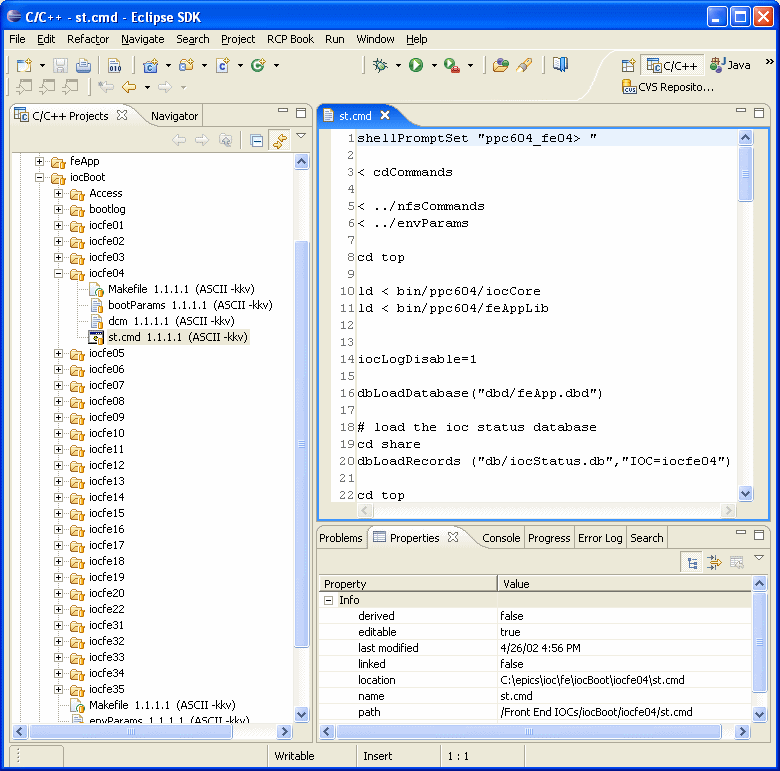

These are the APS front-end IOCs as checked out from CVS and managed in Eclipse.

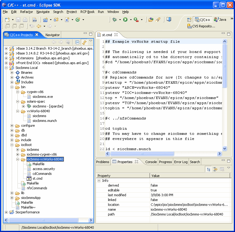

This is a an IOC that has been built for several platforms, including VxWorks.
