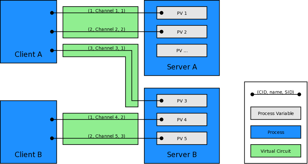

A Process Variable (PV) is representation of a single value within an EPICS host.
A channel is created whenever a PV is connected using CA.
From implementation point of view, a channel is a connection, established over virtual circuit, between server and client through which a single PV is accessed. Both the client and the server will provide a way of uniquely identifying channels. These identifiers are explained in section Message Identifiers.

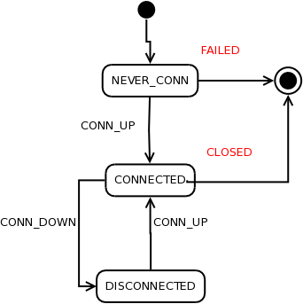

Once virtual circuits are established, client can access values of "A", "B" and "D". From now on, all messages for either of the PVs will be sent via a corresponding virtual circuit.
If virtual circuit looses TCP connection or the host disconnects, client will notify application appropriately. Client will also listen for server beacon messages (sent whenever IOC host starts), to be able to restore any lost connections. Beacons are also used to detect when a host stops responding.
Once the application is done using the channel access library, it will gracefully close any open connections.

Virtual circuit is a TCP connection between a client and a server. Each virtual circuit has an associated priority, which can be used by server to prioritize requests depending on current load. An independent circuit for each priority level selected by the client might be used because it allows for preemptive prioritized dispatch scheduling in the server when the OS supports that, and also allows specifying the networks scheduling priority when the router and or LAN support that. Regardless of how many channels are handled by either client or server, each client-server pair will be connected with exactly one TCP connection for each priority level. This level is specified when creating a virtual circuit.
When establishing a virtual circuit, a simple handshake will be performed. Client will open a TCP connection to the server. After that, it sends CA_PROTO_VERSION, CA_PROTO_CLIENT_NAME and CA_PROTO_HOST_NAME messages. If server accepts all the supplied parameters and the client and host are permitted to connect, the server will respond with CA_PROTO_VERSION. After that, client may start sending requests.
Virtual circuit will remain active as long as there is at least one channel active. If the TCP connection is lost, all channels using this circuit must be notified.

A channel discussed here is based on two levels. One is channel as seen from client application, the other is channel implementation in client library. This difference will be pointed out where applicable.
When a channel is created by client application, it is initialized in NEVER_CONN state. This indicates that channel is currently being connected for the first time. If connection process fails, channel moves into FAILED state and is not usable. Connection proccess within the client library will attempt to connect the channel repeatedly. Intervals between consecutive attempts should be increased, before finally giving up and determining the channel cannot be connected and signaling FAILED state. A total number of attempts can be on the order of 100.
When connection is established, the channel will signal to client with CONN_UP event and changing its state to connected.
Should the virtual circuit connection be lost, CONN_DOWN event will change channel state to disconnected. Whenever virtual circuit is reconnected, the channel state is restored to connected. Note that reconnection process follows the same rules as initial process. It is also possible, that the PV will move between the servers, but client application should not be aware of such internal changes to channel.
Once client application is done using the channel, it will be closed and its state moved changed to CLOSED. After that, this channel can no longer be used.
Detailed description of channel operations is outlined below.
