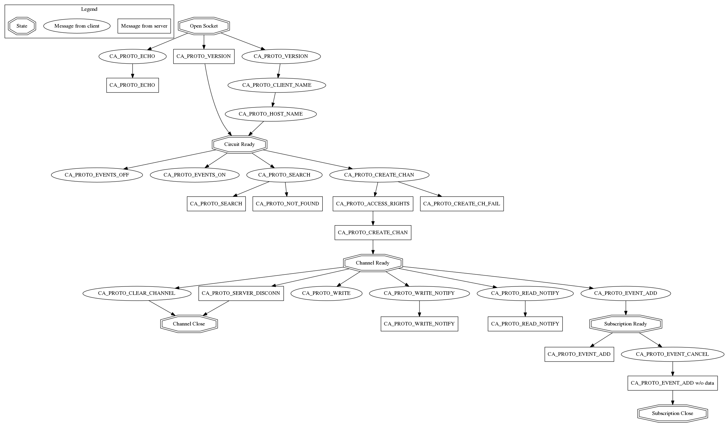

4.2.1. TCP Message Flow
The following tree diagram illustrates the order in which normal (not error) CA messages can be sent on a TCP connection. Nodes with box borders are messages sent be the server, and oval borders are messages sent be the client. Nodes with a double border (eg. "Open Socket") are not themselves messages. Instead they indicate pre-conditions which must be meet before certain messages can be sent.
The message CA_ERROR may be sent by a server in response to any client message.
