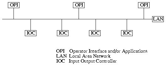

- EPICS IS NOT THE CONTROL SYSTEM!!!
- EPICS is a collection of software tools and other components
- Application Developers use EPICS to create control system
- Tool Based
- Minimize Custom Coding
- Uniform Operator Interface
- Completely Distributed
- No Single Bottle-Neck
- Scales Nicely
- IOC is autonomous system
- Event Driven
- No Polling
- Quick Response
- High Performance
- Workstation (Sun4)
- >2000 screen updates per second
- Quick Display Call-up (goal of < 2 seconds)
- IOC (68040)
- Process >5000 records per second.
- OPI
- Hardware
- UNIX based Workstation (currently sun4)
- Software
- UNIX Operating System
- X Windows
- Motif Toolkit
- LAN
- Hardware
- Software
- TCP/IP Protocols via sockets
- IOC
- Hardware
- VME bus and crates
- Motorola 68020, 68040, 68060 (Power PC in future)
- Various VME/VXI modules: ADCs, DACs, Binary Input, Binary Output, etc.
- Allen Bradley Scanner (Most Allen Bradley I/O modules)
- GPIB devices
- BitBus devices
- Software (vxWorks)
- Real time kernel
- Extensive "Unix like" libraries

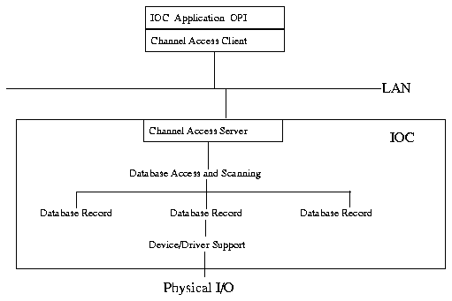

- LAN
- IOC
- Memory Resident Database
- Database Access
- Database Scanners
- Record Support
- Device Support
- Driver Support
- Sequencer (Finite State Machine)
- Custom Code
Network Transparent Access to IOC Databases
- Client/Server Model
- Clients
- UNIX, IOC, VMS, Windows NT (Some)
- Future: ?
- Servers
- A client can communicate with an arbitrary set of servers
- A server accepts connections from an arbitrary set of clients
- Supporting a new OS and/or CPU means porting client (relatively easy)
- Basic Functions
- Search - Locate process variables, Establish connections
- Get - Get value of process variable + extra info (alarm status, etc.)
- Put - Change value of process variable
- Add Event - Add change of state callback (alarm status, value change)
