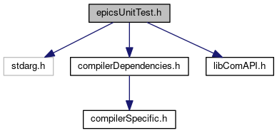

Include dependency graph for epicsUnitTest.h:
This graph shows which files directly or indirectly include this file:
