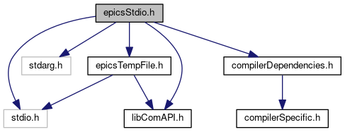

#include <stdio.h>#include <stdarg.h>#include "libComAPI.h"#include "compilerDependencies.h"#include "epicsTempFile.h"
