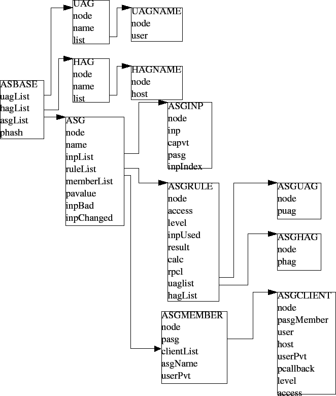

File asLib.h describes the access security data structures and the last section of this chapter has a diagram describing
the relationship between the structures. The structures are:
All structures except ASGMEMBER and ASGCLIENT are created by the access security library itself when it reads an access security file. An ASGMEMBER is created each time asAddMember is called by code that interfaces to the database. An ASGCLIENT is created each time asAddClient is called by a channel access server.

This section provides a few aids for reading the access security code. Include file asLib.h describes the control blocks
used by the access security library.
The following files form the access security system:
Definitions for the portion of access security that is independent of IOC databases.
Definitions for access routines that interface to an IOC database.
Lex and Yacc (actually EPICS flex and antelope) are used to parse the access configuration file. This is the lex input file.
This is the yacc input file. Note that it includes asLibRoutines.c, which do most of the work.
These are the routines that implement access security. This code has no knowledge of the database or channel access. It is a general purpose access security implementation.
This contains the code for interfacing access security to the IOC database.
