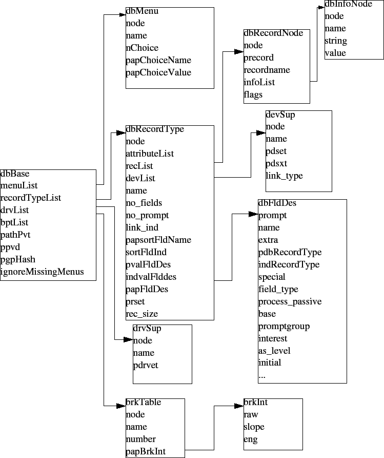

22. Database Structures
This chapter describes the internal structures describing an IOC database. It is of interest to EPICS system developers but
serious application developers may also find it useful. This chapter is intended to make it easier to understand the IOC
source listings. It also gives a list of the header files used by IOC Code.

- dbBase.h
- - Definitions for the structures used to store an EPICS database.
