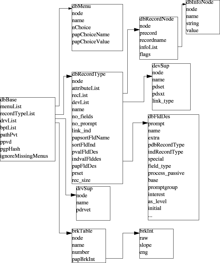

22. Database Structures
This chapter describes the internal structures describing an IOC database.
It is of interest to EPICS system developers but serious application developers may also find it useful.
This chapter was intended to make it easier to understand the IOC source listings, but the information in it is likely to be outdated.
It also lists some of the header files provided for interfacing to IOC code.

- dbBase.h
- - Definitions for the structures used to store an EPICS database.
