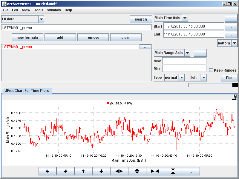

CSS Folks,We are using CSS Data Browser to access data from the EPICS Channel Archiver. We have encountered a case in which CSS Data Browser does not display a PV correctly. It can export the data (so has certainly retrieved it from the Archiver). The old Archive Viewer displays the data correctly. Note this problem is specific to a particular PV but I have no idea what the problem is for this PV. Attached are screen shots of Archive Viewer display and CSS Data Browser display. Any suggestions? John Dobbins Cornell University exported data: # Created by CSS Data Browser Version 2.0.5.20101112 # # Start Time : 2010/11/16 20:45:00.000000000 # End Time : 2010/11/16 20:46:00.000000000 # Source : Optimized Archived Data # Desired Value Count: 1000 # Format : Default format # # Data is in TAB-delimited columns, should import into e.g. Excel # Channel: LGTPMA01_power # Archives: # 1) L0 data # URL: xnds://erd101.lns.cornell.edu/archive/cgi/ArchiveDataServer.cgi # Key: 4613 # # Time LGTPMA01_power Value Severity Status 2010/11/16 20:45:00.000000000 0.135 OK OK 2010/11/16 20:45:00.040189000 0.135 OK OK 2010/11/16 20:45:00.173832000 0.135 OK OK 2010/11/16 20:45:00.240706000 0.135 OK OK 2010/11/16 20:45:00.374419000 0.136 OK OK 2010/11/16 20:45:00.440251000 0.136 OK OK 2010/11/16 20:45:00.573690000 0.136 OK OK 2010/11/16 20:45:00.640340000 0.134 OK OK 2010/11/16 20:45:00.773465000 0.134 OK OK 2010/11/16 20:45:00.841988000 0.134 OK OK 2010/11/16 20:45:00.973790000 0.135 OK OK 2010/11/16 20:45:01.106808000 0.134 OK OK 2010/11/16 20:45:01.174316000 0.135 OK OK 2010/11/16 20:45:01.306752000 0.135 OK OK 2010/11/16 20:45:01.373822000 0.136 OK OK 2010/11/16 20:45:01.506809000 0.135 OK OK 2010/11/16 20:45:01.573770000 0.134 OK OK 2010/11/16 20:45:01.706696000 0.133 OK OK 2010/11/16 20:45:01.773326000 0.134 OK OK 2010/11/16 20:45:01.906592000 0.132 OK OK 2010/11/16 20:45:01.973367000 0.132 OK OK 2010/11/16 20:45:02.106912000 0.130 OK OK 2010/11/16 20:45:02.173184000 0.132 OK OK 2010/11/16 20:45:02.306631000 0.130 OK OK 2010/11/16 20:45:02.373401000 0.130 OK OK 2010/11/16 20:45:02.506562000 0.130 OK OK 2010/11/16 20:45:02.573423000 0.131 OK OK 2010/11/16 20:45:02.706590000 0.130 OK OK 2010/11/16 20:45:02.906581000 0.130 OK OK 2010/11/16 20:45:02.974181000 0.129 OK OK 2010/11/16 20:45:03.106427000 0.130 OK OK 2010/11/16 20:45:03.174632000 0.130 OK OK 2010/11/16 20:45:03.306399000 0.129 OK OK 2010/11/16 20:45:03.439708000 0.129 OK OK 2010/11/16 20:45:03.506601000 0.129 OK OK 2010/11/16 20:45:03.639726000 0.130 OK OK 2010/11/16 20:45:03.706336000 0.130 OK OK 2010/11/16 20:45:03.839721000 0.129 OK OK 2010/11/16 20:45:03.906229000 0.130 OK OK 2010/11/16 20:45:04.039709000 0.130 OK OK 2010/11/16 20:45:04.106200000 0.130 OK OK 2010/11/16 20:45:04.239484000 0.133 OK OK 2010/11/16 20:45:04.306180000 0.132 OK OK 2010/11/16 20:45:04.439735000 0.132 OK OK 2010/11/16 20:45:04.506157000 0.132 OK OK 2010/11/16 20:45:04.639481000 0.131 OK OK 2010/11/16 20:45:04.706175000 0.132 OK OK 2010/11/16 20:45:04.839456000 0.133 OK OK 2010/11/16 20:45:04.906339000 0.134 OK OK 2010/11/16 20:45:05.039331000 0.132 OK OK 2010/11/16 20:45:05.106006000 0.134 OK OK 2010/11/16 20:45:05.307443000 0.135 OK OK 2010/11/16 20:45:05.439336000 0.133 OK OK 2010/11/16 20:45:05.507634000 0.133 OK OK 2010/11/16 20:45:05.639238000 0.134 OK OK 2010/11/16 20:45:05.772633000 0.133 OK OK 2010/11/16 20:45:05.839447000 0.134 OK OK 2010/11/16 20:45:05.972478000 0.133 OK OK 2010/11/16 20:45:06.039108000 0.134 OK OK 2010/11/16 20:45:06.172424000 0.132 OK OK 2010/11/16 20:45:06.239176000 0.134 OK OK 2010/11/16 20:45:06.372470000 0.136 OK OK 2010/11/16 20:45:06.439126000 0.135 OK OK 2010/11/16 20:45:06.572442000 0.131 OK OK 2010/11/16 20:45:06.639058000 0.133 OK OK 2010/11/16 20:45:06.772644000 0.133 OK OK 2010/11/16 20:45:06.839077000 0.132 OK OK 2010/11/16 20:45:06.972298000 0.132 OK OK 2010/11/16 20:45:07.038941000 0.133 OK OK 2010/11/16 20:45:07.172351000 0.131 OK OK 2010/11/16 20:45:07.239176000 0.132 OK OK 2010/11/16 20:45:07.372314000 0.133 OK OK 2010/11/16 20:45:07.439056000 0.133 OK OK 2010/11/16 20:45:07.572185000 0.133 OK OK 2010/11/16 20:45:07.638876000 0.134 OK OK 2010/11/16 20:45:07.772257000 0.133 OK OK 2010/11/16 20:45:07.840424000 0.134 OK OK 2010/11/16 20:45:07.972089000 0.135 OK OK 2010/11/16 20:45:08.105510000 0.137 OK OK 2010/11/16 20:45:08.172431000 0.133 OK OK 2010/11/16 20:45:08.305435000 0.132 OK OK 2010/11/16 20:45:08.372085000 0.133 OK OK 2010/11/16 20:45:08.572053000 0.133 OK OK 2010/11/16 20:45:08.705407000 0.136 OK OK 2010/11/16 20:45:08.772073000 0.136 OK OK 2010/11/16 20:45:08.905431000 0.135 OK OK 2010/11/16 20:45:08.971929000 0.136 OK OK 2010/11/16 20:45:09.105610000 0.134 OK OK 2010/11/16 20:45:09.171866000 0.136 OK OK 2010/11/16 20:45:09.305283000 0.135 OK OK 2010/11/16 20:45:09.371831000 0.134 OK OK 2010/11/16 20:45:09.505644000 0.138 OK OK 2010/11/16 20:45:09.572311000 0.138 OK OK 2010/11/16 20:45:09.705226000 0.136 OK OK 2010/11/16 20:45:09.905196000 0.134 OK OK 2010/11/16 20:45:09.973085000 0.134 OK OK 2010/11/16 20:45:10.105132000 0.135 OK OK 2010/11/16 20:45:10.174066000 0.135 OK OK 2010/11/16 20:45:10.305083000 0.136 OK OK 2010/11/16 20:45:10.438885000 0.135 OK OK 2010/11/16 20:45:10.505267000 0.135 OK OK 2010/11/16 20:45:10.638871000 0.136 OK OK 2010/11/16 20:45:10.705040000 0.135 OK OK 2010/11/16 20:45:10.838375000 0.135 OK OK 2010/11/16 20:45:10.905044000 0.136 OK OK 2010/11/16 20:45:11.038347000 0.136 OK OK 2010/11/16 20:45:11.104939000 0.135 OK OK 2010/11/16 20:45:11.238654000 0.134 OK OK 2010/11/16 20:45:11.304865000 0.134 OK OK 2010/11/16 20:45:11.438927000 0.135 OK OK 2010/11/16 20:45:11.638310000 0.134 OK OK 2010/11/16 20:45:11.705257000 0.133 OK OK 2010/11/16 20:45:11.838161000 0.133 OK OK 2010/11/16 20:45:11.905049000 0.134 OK OK 2010/11/16 20:45:12.104748000 0.134 OK OK 2010/11/16 20:45:12.238139000 0.132 OK OK 2010/11/16 20:45:12.304644000 0.132 OK OK 2010/11/16 20:45:12.438156000 0.132 OK OK 2010/11/16 20:45:12.504710000 0.132 OK OK 2010/11/16 20:45:12.638015000 0.131 OK OK 2010/11/16 20:45:12.704624000 0.132 OK OK 2010/11/16 20:45:12.838769000 0.132 OK OK 2010/11/16 20:45:13.037817000 0.132 OK OK 2010/11/16 20:45:13.105977000 0.132 OK OK 2010/11/16 20:45:13.237772000 0.133 OK OK 2010/11/16 20:45:13.306345000 0.132 OK OK 2010/11/16 20:45:13.437794000 0.133 OK OK 2010/11/16 20:45:13.637751000 0.132 OK OK 2010/11/16 20:45:13.771331000 0.132 OK OK 2010/11/16 20:45:13.837801000 0.132 OK OK 2010/11/16 20:45:13.971722000 0.133 OK OK 2010/11/16 20:45:14.037749000 0.132 OK OK 2010/11/16 20:45:14.171074000 0.133 OK OK 2010/11/16 20:45:14.238092000 0.132 OK OK 2010/11/16 20:45:14.370879000 0.131 OK OK 2010/11/16 20:45:14.437609000 0.131 OK OK 2010/11/16 20:45:14.570967000 0.132 OK OK 2010/11/16 20:45:14.637554000 0.132 OK OK 2010/11/16 20:45:14.770979000 0.132 OK OK 2010/11/16 20:45:14.837568000 0.132 OK OK 2010/11/16 20:45:14.970913000 0.132 OK OK 2010/11/16 20:45:15.037580000 0.132 OK OK 2010/11/16 20:45:15.171067000 0.135 OK OK 2010/11/16 20:45:15.237431000 0.132 OK OK 2010/11/16 20:45:15.370737000 0.131 OK OK 2010/11/16 20:45:15.570778000 0.131 OK OK 2010/11/16 20:45:15.637547000 0.134 OK OK 2010/11/16 20:45:15.770683000 0.131 OK OK 2010/11/16 20:45:15.837384000 0.134 OK OK 2010/11/16 20:45:15.970734000 0.135 OK OK 2010/11/16 20:45:16.037289000 0.134 OK OK 2010/11/16 20:45:16.170713000 0.133 OK OK 2010/11/16 20:45:16.238160000 0.135 OK OK 2010/11/16 20:45:16.370784000 0.133 OK OK 2010/11/16 20:45:16.438797000 0.131 OK OK 2010/11/16 20:45:16.570802000 0.132 OK OK 2010/11/16 20:45:16.704039000 0.133 OK OK 2010/11/16 20:45:16.770554000 0.131 OK OK 2010/11/16 20:45:16.904035000 0.132 OK OK 2010/11/16 20:45:16.970552000 0.133 OK OK 2010/11/16 20:45:17.104009000 0.131 OK OK 2010/11/16 20:45:17.170443000 0.130 OK OK 2010/11/16 20:45:17.303992000 0.132 OK OK 2010/11/16 20:45:17.370654000 0.131 OK OK 2010/11/16 20:45:17.503930000 0.132 OK OK 2010/11/16 20:45:17.570476000 0.131 OK OK 2010/11/16 20:45:17.703745000 0.131 OK OK 2010/11/16 20:45:17.770342000 0.133 OK OK 2010/11/16 20:45:17.903802000 0.132 OK OK 2010/11/16 20:45:17.970588000 0.131 OK OK 2010/11/16 20:45:18.103768000 0.132 OK OK 2010/11/16 20:45:18.170200000 0.131 OK OK 2010/11/16 20:45:18.303854000 0.132 OK OK 2010/11/16 20:45:18.370462000 0.130 OK OK 2010/11/16 20:45:18.503867000 0.130 OK OK 2010/11/16 20:45:18.571211000 0.131 OK OK 2010/11/16 20:45:18.703753000 0.133 OK OK 2010/11/16 20:45:18.903767000 0.133 OK OK 2010/11/16 20:45:18.970250000 0.132 OK OK 2010/11/16 20:45:19.103667000 0.132 OK OK 2010/11/16 20:45:19.169979000 0.130 OK OK 2010/11/16 20:45:19.303891000 0.130 OK OK 2010/11/16 20:45:19.372615000 0.129 OK OK 2010/11/16 20:45:19.572370000 0.129 OK OK 2010/11/16 20:45:19.703813000 0.130 OK OK 2010/11/16 20:45:19.836894000 0.129 OK OK 2010/11/16 20:45:19.903790000 0.129 OK OK 2010/11/16 20:45:20.103605000 0.131 OK OK 2010/11/16 20:45:20.236497000 0.132 OK OK 2010/11/16 20:45:20.303826000 0.133 OK OK 2010/11/16 20:45:20.437265000 0.132 OK OK 2010/11/16 20:45:20.503918000 0.133 OK OK 2010/11/16 20:45:20.636570000 0.133 OK OK 2010/11/16 20:45:20.703684000 0.132 OK OK 2010/11/16 20:45:20.904282000 0.132 OK OK 2010/11/16 20:45:21.036427000 0.134 OK OK 2010/11/16 20:45:21.103730000 0.133 OK OK 2010/11/16 20:45:21.236574000 0.134 OK OK 2010/11/16 20:45:21.303696000 0.133 OK OK 2010/11/16 20:45:21.436389000 0.132 OK OK 2010/11/16 20:45:21.503574000 0.131 OK OK 2010/11/16 20:45:21.636320000 0.131 OK OK 2010/11/16 20:45:21.703755000 0.130 OK OK 2010/11/16 20:45:21.836320000 0.131 OK OK 2010/11/16 20:45:21.903402000 0.130 OK OK 2010/11/16 20:45:22.036148000 0.130 OK OK 2010/11/16 20:45:22.103088000 0.131 OK OK 2010/11/16 20:45:22.236643000 0.132 OK OK 2010/11/16 20:45:22.303692000 0.132 OK OK 2010/11/16 20:45:22.436171000 0.131 OK OK 2010/11/16 20:45:22.504235000 0.132 OK OK 2010/11/16 20:45:22.636322000 0.133 OK OK 2010/11/16 20:45:22.769424000 0.132 OK OK 2010/11/16 20:45:22.836012000 0.132 OK OK 2010/11/16 20:45:22.969408000 0.133 OK OK 2010/11/16 20:45:23.169217000 0.133 OK OK 2010/11/16 20:45:23.235961000 0.133 OK OK 2010/11/16 20:45:23.370540000 0.134 OK OK 2010/11/16 20:45:23.435876000 0.134 OK OK 2010/11/16 20:45:23.569475000 0.133 OK OK 2010/11/16 20:45:23.635856000 0.133 OK OK 2010/11/16 20:45:23.769295000 0.132 OK OK 2010/11/16 20:45:23.835834000 0.132 OK OK 2010/11/16 20:45:23.969162000 0.134 OK OK 2010/11/16 20:45:24.035990000 0.135 OK OK 2010/11/16 20:45:24.169091000 0.135 OK OK 2010/11/16 20:45:24.235733000 0.134 OK OK 2010/11/16 20:45:24.370886000 0.136 OK OK 2010/11/16 20:45:24.435649000 0.136 OK OK 2010/11/16 20:45:24.569058000 0.134 OK OK 2010/11/16 20:45:24.635581000 0.135 OK OK 2010/11/16 20:45:24.768967000 0.134 OK OK 2010/11/16 20:45:24.835603000 0.134 OK OK 2010/11/16 20:45:24.969241000 0.135 OK OK 2010/11/16 20:45:25.035539000 0.134 OK OK 2010/11/16 20:45:25.168890000 0.133 OK OK 2010/11/16 20:45:25.235568000 0.133 OK OK 2010/11/16 20:45:25.369727000 0.132 OK OK 2010/11/16 20:45:25.436033000 0.134 OK OK 2010/11/16 20:45:25.568877000 0.134 OK OK 2010/11/16 20:45:25.637055000 0.133 OK OK 2010/11/16 20:45:25.768750000 0.132 OK OK 2010/11/16 20:45:25.902535000 0.133 OK OK 2010/11/16 20:45:25.968727000 0.134 OK OK 2010/11/16 20:45:26.102076000 0.137 OK OK 2010/11/16 20:45:26.168638000 0.137 OK OK 2010/11/16 20:45:26.302067000 0.137 OK OK 2010/11/16 20:45:26.369279000 0.137 OK OK 2010/11/16 20:45:26.502016000 0.137 OK OK 2010/11/16 20:45:26.568685000 0.135 OK OK 2010/11/16 20:45:26.701914000 0.137 OK OK 2010/11/16 20:45:26.768585000 0.136 OK OK 2010/11/16 20:45:26.901806000 0.137 OK OK 2010/11/16 20:45:26.968566000 0.136 OK OK 2010/11/16 20:45:27.101891000 0.138 OK OK 2010/11/16 20:45:27.168670000 0.138 OK OK 2010/11/16 20:45:27.302078000 0.137 OK OK 2010/11/16 20:45:27.369670000 0.136 OK OK 2010/11/16 20:45:27.501795000 0.138 OK OK 2010/11/16 20:45:27.568538000 0.137 OK OK 2010/11/16 20:45:27.701702000 0.136 OK OK 2010/11/16 20:45:27.768701000 0.136 OK OK 2010/11/16 20:45:27.901661000 0.135 OK OK 2010/11/16 20:45:27.968883000 0.134 OK OK 2010/11/16 20:45:28.101690000 0.133 OK OK 2010/11/16 20:45:28.168546000 0.133 OK OK 2010/11/16 20:45:28.301627000 0.134 OK OK 2010/11/16 20:45:28.369275000 0.134 OK OK 2010/11/16 20:45:28.501577000 0.137 OK OK 2010/11/16 20:45:28.569838000 0.136 OK OK 2010/11/16 20:45:28.701807000 0.138 OK OK 2010/11/16 20:45:28.769675000 0.138 OK OK 2010/11/16 20:45:28.901473000 0.138 OK OK 2010/11/16 20:45:29.034862000 0.137 OK OK 2010/11/16 20:45:29.101477000 0.138 OK OK 2010/11/16 20:45:29.234891000 0.136 OK OK 2010/11/16 20:45:29.302136000 0.136 OK OK 2010/11/16 20:45:29.435074000 0.135 OK OK 2010/11/16 20:45:29.501759000 0.136 OK OK 2010/11/16 20:45:29.635208000 0.134 OK OK 2010/11/16 20:45:29.701359000 0.136 OK OK 2010/11/16 20:45:29.834647000 0.134 OK OK 2010/11/16 20:45:30.034709000 0.136 OK OK 2010/11/16 20:45:30.101555000 0.138 OK OK 2010/11/16 20:45:30.234693000 0.134 OK OK 2010/11/16 20:45:30.301234000 0.133 OK OK 2010/11/16 20:45:30.435144000 0.134 OK OK 2010/11/16 20:45:30.501283000 0.134 OK OK 2010/11/16 20:45:30.634455000 0.133 OK OK 2010/11/16 20:45:30.701136000 0.132 OK OK 2010/11/16 20:45:30.834516000 0.132 OK OK 2010/11/16 20:45:30.901288000 0.133 OK OK 2010/11/16 20:45:31.034649000 0.135 OK OK 2010/11/16 20:45:31.101071000 0.131 OK OK 2010/11/16 20:45:31.234405000 0.134 OK OK 2010/11/16 20:45:31.303317000 0.133 OK OK 2010/11/16 20:45:31.434418000 0.134 OK OK 2010/11/16 20:45:31.503457000 0.133 OK OK 2010/11/16 20:45:31.634268000 0.134 OK OK 2010/11/16 20:45:31.767715000 0.134 OK OK 2010/11/16 20:45:31.834271000 0.133 OK OK 2010/11/16 20:45:31.967829000 0.132 OK OK 2010/11/16 20:45:32.034211000 0.133 OK OK 2010/11/16 20:45:32.167702000 0.132 OK OK 2010/11/16 20:45:32.234232000 0.132 OK OK 2010/11/16 20:45:32.367719000 0.133 OK OK 2010/11/16 20:45:32.434482000 0.132 OK OK 2010/11/16 20:45:32.567677000 0.133 OK OK 2010/11/16 20:45:32.634051000 0.134 OK OK 2010/11/16 20:45:32.767643000 0.135 OK OK 2010/11/16 20:45:32.834011000 0.134 OK OK 2010/11/16 20:45:32.967514000 0.134 OK OK 2010/11/16 20:45:33.034015000 0.133 OK OK 2010/11/16 20:45:33.167465000 0.135 OK OK 2010/11/16 20:45:33.234026000 0.134 OK OK 2010/11/16 20:45:33.367919000 0.135 OK OK 2010/11/16 20:45:33.434036000 0.134 OK OK 2010/11/16 20:45:33.567349000 0.133 OK OK 2010/11/16 20:45:33.633826000 0.134 OK OK 2010/11/16 20:45:33.767457000 0.135 OK OK 2010/11/16 20:45:33.834212000 0.135 OK OK 2010/11/16 20:45:33.967330000 0.135 OK OK 2010/11/16 20:45:34.033895000 0.135 OK OK 2010/11/16 20:45:34.167327000 0.135 OK OK 2010/11/16 20:45:34.234190000 0.134 OK OK 2010/11/16 20:45:34.367484000 0.133 OK OK 2010/11/16 20:45:34.435311000 0.131 OK OK 2010/11/16 20:45:34.567296000 0.132 OK OK 2010/11/16 20:45:34.635395000 0.132 OK OK 2010/11/16 20:45:34.767592000 0.132 OK OK 2010/11/16 20:45:34.900388000 0.133 OK OK 2010/11/16 20:45:34.967046000 0.133 OK OK 2010/11/16 20:45:35.100299000 0.132 OK OK 2010/11/16 20:45:35.167009000 0.131 OK OK 2010/11/16 20:45:35.300333000 0.131 OK OK 2010/11/16 20:45:35.368670000 0.130 OK OK 2010/11/16 20:45:35.500352000 0.131 OK OK 2010/11/16 20:45:35.700517000 0.131 OK OK 2010/11/16 20:45:35.766846000 0.131 OK OK 2010/11/16 20:45:35.900193000 0.131 OK OK 2010/11/16 20:45:35.966855000 0.134 OK OK 2010/11/16 20:45:36.166930000 0.133 OK OK 2010/11/16 20:45:36.300309000 0.134 OK OK 2010/11/16 20:45:36.366720000 0.134 OK OK 2010/11/16 20:45:36.499996000 0.135 OK OK 2010/11/16 20:45:36.566548000 0.135 OK OK 2010/11/16 20:45:36.699979000 0.137 OK OK 2010/11/16 20:45:36.766542000 0.135 OK OK 2010/11/16 20:45:36.899962000 0.136 OK OK 2010/11/16 20:45:36.966734000 0.135 OK OK 2010/11/16 20:45:37.100179000 0.136 OK OK 2010/11/16 20:45:37.166769000 0.135 OK OK 2010/11/16 20:45:37.300020000 0.135 OK OK 2010/11/16 20:45:37.368826000 0.135 OK OK 2010/11/16 20:45:37.499823000 0.135 OK OK 2010/11/16 20:45:37.568430000 0.136 OK OK 2010/11/16 20:45:37.699786000 0.136 OK OK 2010/11/16 20:45:37.833118000 0.134 OK OK 2010/11/16 20:45:37.899796000 0.135 OK OK 2010/11/16 20:45:38.033758000 0.136 OK OK 2010/11/16 20:45:38.099785000 0.135 OK OK 2010/11/16 20:45:38.233098000 0.136 OK OK 2010/11/16 20:45:38.299767000 0.134 OK OK 2010/11/16 20:45:38.433001000 0.134 OK OK 2010/11/16 20:45:38.500543000 0.133 OK OK 2010/11/16 20:45:38.632990000 0.134 OK OK 2010/11/16 20:45:38.699638000 0.133 OK OK 2010/11/16 20:45:38.833001000 0.136 OK OK 2010/11/16 20:45:38.899570000 0.135 OK OK 2010/11/16 20:45:39.033010000 0.133 OK OK 2010/11/16 20:45:39.099553000 0.133 OK OK 2010/11/16 20:45:39.232971000 0.133 OK OK 2010/11/16 20:45:39.299594000 0.134 OK OK 2010/11/16 20:45:39.433859000 0.138 OK OK 2010/11/16 20:45:39.499475000 0.136 OK OK 2010/11/16 20:45:39.632834000 0.136 OK OK 2010/11/16 20:45:39.699466000 0.135 OK OK 2010/11/16 20:45:39.832769000 0.133 OK OK 2010/11/16 20:45:39.899603000 0.135 OK OK 2010/11/16 20:45:40.032906000 0.135 OK OK 2010/11/16 20:45:40.099317000 0.136 OK OK 2010/11/16 20:45:40.232827000 0.135 OK OK 2010/11/16 20:45:40.299936000 0.133 OK OK 2010/11/16 20:45:40.432819000 0.134 OK OK 2010/11/16 20:45:40.500915000 0.135 OK OK 2010/11/16 20:45:40.632792000 0.135 OK OK 2010/11/16 20:45:40.765914000 0.135 OK OK 2010/11/16 20:45:40.832791000 0.134 OK OK 2010/11/16 20:45:40.965900000 0.134 OK OK 2010/11/16 20:45:41.032744000 0.136 OK OK 2010/11/16 20:45:41.165879000 0.135 OK OK 2010/11/16 20:45:41.232690000 0.134 OK OK 2010/11/16 20:45:41.365841000 0.134 OK OK 2010/11/16 20:45:41.432840000 0.134 OK OK 2010/11/16 20:45:41.565718000 0.133 OK OK 2010/11/16 20:45:41.632699000 0.134 OK OK 2010/11/16 20:45:41.765953000 0.134 OK OK 2010/11/16 20:45:41.832705000 0.134 OK OK 2010/11/16 20:45:41.965717000 0.133 OK OK 2010/11/16 20:45:42.032692000 0.134 OK OK 2010/11/16 20:45:42.165675000 0.135 OK OK 2010/11/16 20:45:42.232725000 0.136 OK OK 2010/11/16 20:45:42.365597000 0.134 OK OK 2010/11/16 20:45:42.432894000 0.137 OK OK 2010/11/16 20:45:42.565570000 0.135 OK OK 2010/11/16 20:45:42.632580000 0.134 OK OK 2010/11/16 20:45:42.765517000 0.135 OK OK 2010/11/16 20:45:42.832572000 0.134 OK OK 2010/11/16 20:45:42.965547000 0.135 OK OK 2010/11/16 20:45:43.032492000 0.134 OK OK 2010/11/16 20:45:43.165710000 0.134 OK OK 2010/11/16 20:45:43.232606000 0.132 OK OK 2010/11/16 20:45:43.365402000 0.132 OK OK 2010/11/16 20:45:43.433246000 0.128 OK OK 2010/11/16 20:45:43.565324000 0.132 OK OK 2010/11/16 20:45:43.633724000 0.132 OK OK 2010/11/16 20:45:43.765309000 0.133 OK OK 2010/11/16 20:45:43.833638000 0.134 OK OK 2010/11/16 20:45:43.965277000 0.131 OK OK 2010/11/16 20:45:44.098836000 0.131 OK OK 2010/11/16 20:45:44.165361000 0.133 OK OK 2010/11/16 20:45:44.298663000 0.134 OK OK 2010/11/16 20:45:44.365241000 0.133 OK OK 2010/11/16 20:45:44.498506000 0.133 OK OK 2010/11/16 20:45:44.565477000 0.133 OK OK 2010/11/16 20:45:44.698532000 0.132 OK OK 2010/11/16 20:45:44.765120000 0.132 OK OK 2010/11/16 20:45:44.898479000 0.134 OK OK 2010/11/16 20:45:44.965145000 0.135 OK OK 2010/11/16 20:45:45.098474000 0.135 OK OK 2010/11/16 20:45:45.165020000 0.137 OK OK 2010/11/16 20:45:45.298423000 0.138 OK OK 2010/11/16 20:45:45.364895000 0.138 OK OK 2010/11/16 20:45:45.498679000 0.137 OK OK 2010/11/16 20:45:45.564851000 0.138 OK OK 2010/11/16 20:45:45.698342000 0.136 OK OK 2010/11/16 20:45:45.764916000 0.136 OK OK 2010/11/16 20:45:45.898211000 0.136 OK OK 2010/11/16 20:45:45.965086000 0.135 OK OK 2010/11/16 20:45:46.098326000 0.135 OK OK 2010/11/16 20:45:46.164899000 0.133 OK OK 2010/11/16 20:45:46.298217000 0.135 OK OK 2010/11/16 20:45:46.364762000 0.136 OK OK 2010/11/16 20:45:46.498143000 0.136 OK OK 2010/11/16 20:45:46.566650000 0.136 OK OK 2010/11/16 20:45:46.698133000 0.136 OK OK 2010/11/16 20:45:46.766376000 0.135 OK OK 2010/11/16 20:45:47.031501000 0.136 OK OK 2010/11/16 20:45:47.098037000 0.138 OK OK 2010/11/16 20:45:47.231414000 0.137 OK OK 2010/11/16 20:45:47.297947000 0.135 OK OK 2010/11/16 20:45:47.497985000 0.134 OK OK 2010/11/16 20:45:47.632196000 0.135 OK OK 2010/11/16 20:45:47.697905000 0.134 OK OK 2010/11/16 20:45:47.831452000 0.133 OK OK 2010/11/16 20:45:47.897899000 0.134 OK OK 2010/11/16 20:45:48.031247000 0.134 OK OK 2010/11/16 20:45:48.097916000 0.134 OK OK 2010/11/16 20:45:48.231151000 0.134 OK OK 2010/11/16 20:45:48.298154000 0.136 OK OK 2010/11/16 20:45:48.431083000 0.134 OK OK 2010/11/16 20:45:48.498233000 0.136 OK OK 2010/11/16 20:45:48.631072000 0.134 OK OK 2010/11/16 20:45:48.697751000 0.136 OK OK 2010/11/16 20:45:48.831086000 0.135 OK OK 2010/11/16 20:45:48.897800000 0.134 OK OK 2010/11/16 20:45:49.031132000 0.135 OK OK 2010/11/16 20:45:49.097697000 0.134 OK OK 2010/11/16 20:45:49.231296000 0.134 OK OK 2010/11/16 20:45:49.297974000 0.135 OK OK 2010/11/16 20:45:49.431297000 0.134 OK OK 2010/11/16 20:45:49.499401000 0.135 OK OK 2010/11/16 20:45:49.630888000 0.135 OK OK 2010/11/16 20:45:49.699457000 0.135 OK OK 2010/11/16 20:45:49.831000000 0.133 OK OK 2010/11/16 20:45:49.964163000 0.134 OK OK 2010/11/16 20:45:50.030856000 0.132 OK OK 2010/11/16 20:45:50.164405000 0.133 OK OK 2010/11/16 20:45:50.231181000 0.132 OK OK 2010/11/16 20:45:50.364033000 0.131 OK OK 2010/11/16 20:45:50.430741000 0.132 OK OK 2010/11/16 20:45:50.564094000 0.134 OK OK 2010/11/16 20:45:50.630857000 0.132 OK OK 2010/11/16 20:45:50.764034000 0.133 OK OK 2010/11/16 20:45:50.830669000 0.132 OK OK 2010/11/16 20:45:50.964002000 0.132 OK OK 2010/11/16 20:45:51.030647000 0.132 OK OK 2010/11/16 20:45:51.164006000 0.134 OK OK 2010/11/16 20:45:51.230705000 0.134 OK OK 2010/11/16 20:45:51.363866000 0.133 OK OK 2010/11/16 20:45:51.430515000 0.134 OK OK 2010/11/16 20:45:51.564087000 0.133 OK OK 2010/11/16 20:45:51.630425000 0.135 OK OK 2010/11/16 20:45:51.763858000 0.134 OK OK 2010/11/16 20:45:51.830419000 0.135 OK OK 2010/11/16 20:45:51.963814000 0.136 OK OK 2010/11/16 20:45:52.030586000 0.136 OK OK 2010/11/16 20:45:52.163805000 0.135 OK OK 2010/11/16 20:45:52.230412000 0.136 OK OK 2010/11/16 20:45:52.363668000 0.137 OK OK 2010/11/16 20:45:52.432180000 0.136 OK OK 2010/11/16 20:45:52.563662000 0.136 OK OK 2010/11/16 20:45:52.632181000 0.136 OK OK 2010/11/16 20:45:52.763654000 0.134 OK OK 2010/11/16 20:45:52.832132000 0.136 OK OK 2010/11/16 20:45:52.963792000 0.136 OK OK 2010/11/16 20:45:53.097143000 0.136 OK OK 2010/11/16 20:45:53.163615000 0.135 OK OK 2010/11/16 20:45:53.297164000 0.135 OK OK 2010/11/16 20:45:53.363620000 0.135 OK OK 2010/11/16 20:45:53.497370000 0.137 OK OK 2010/11/16 20:45:53.563582000 0.136 OK OK 2010/11/16 20:45:53.697198000 0.137 OK OK 2010/11/16 20:45:53.763434000 0.136 OK OK 2010/11/16 20:45:53.897375000 0.140 OK OK 2010/11/16 20:45:53.963388000 0.138 OK OK 2010/11/16 20:45:54.097335000 0.139 OK OK 2010/11/16 20:45:54.163385000 0.138 OK OK 2010/11/16 20:45:54.297019000 0.138 OK OK 2010/11/16 20:45:54.363560000 0.138 OK OK 2010/11/16 20:45:54.497134000 0.138 OK OK 2010/11/16 20:45:54.563236000 0.139 OK OK 2010/11/16 20:45:54.696640000 0.141 OK OK 2010/11/16 20:45:54.896622000 0.141 OK OK 2010/11/16 20:45:54.963310000 0.140 OK OK 2010/11/16 20:45:55.096749000 0.140 OK OK 2010/11/16 20:45:55.163241000 0.140 OK OK 2010/11/16 20:45:55.363347000 0.139 OK OK 2010/11/16 20:45:55.496599000 0.140 OK OK 2010/11/16 20:45:55.564890000 0.139 OK OK 2010/11/16 20:45:55.696585000 0.140 OK OK 2010/11/16 20:45:55.764865000 0.140 OK OK 2010/11/16 20:45:55.896451000 0.138 OK OK 2010/11/16 20:45:56.029743000 0.138 OK OK 2010/11/16 20:45:56.096570000 0.140 OK OK 2010/11/16 20:45:56.229962000 0.138 OK OK 2010/11/16 20:45:56.429779000 0.140 OK OK 2010/11/16 20:45:56.629659000 0.138 OK OK 2010/11/16 20:45:56.696554000 0.139 OK OK 2010/11/16 20:45:56.829557000 0.137 OK OK 2010/11/16 20:45:57.029516000 0.135 OK OK 2010/11/16 20:45:57.096174000 0.135 OK OK 2010/11/16 20:45:57.229549000 0.136 OK OK 2010/11/16 20:45:57.296165000 0.135 OK OK 2010/11/16 20:45:57.429485000 0.137 OK OK 2010/11/16 20:45:57.496079000 0.135 OK OK 2010/11/16 20:45:57.630036000 0.135 OK OK 2010/11/16 20:45:57.696021000 0.136 OK OK 2010/11/16 20:45:57.829378000 0.136 OK OK 2010/11/16 20:45:57.896052000 0.135 OK OK 2010/11/16 20:45:58.029637000 0.133 OK OK 2010/11/16 20:45:58.096174000 0.134 OK OK 2010/11/16 20:45:58.229374000 0.135 OK OK 2010/11/16 20:45:58.295945000 0.134 OK OK 2010/11/16 20:45:58.429274000 0.135 OK OK 2010/11/16 20:45:58.495892000 0.135 OK OK 2010/11/16 20:45:58.629298000 0.136 OK OK 2010/11/16 20:45:58.697407000 0.135 OK OK 2010/11/16 20:45:58.829193000 0.135 OK OK 2010/11/16 20:45:58.897406000 0.135 OK OK 2010/11/16 20:45:59.029409000 0.137 OK OK 2010/11/16 20:45:59.162513000 0.139 OK OK 2010/11/16 20:45:59.229093000 0.140 OK OK 2010/11/16 20:45:59.362470000 0.138 OK OK 2010/11/16 20:45:59.429173000 0.137 OK OK 2010/11/16 20:45:59.562441000 0.138 OK OK 2010/11/16 20:45:59.628969000 0.138 OK OK 2010/11/16 20:45:59.762337000 0.136 OK OK 2010/11/16 20:45:59.828906000 0.136 OK OK 2010/11/16 20:45:59.962525000 0.135 OK OK Attachment:
cornell_archiver_viewer.PNG Attachment:
