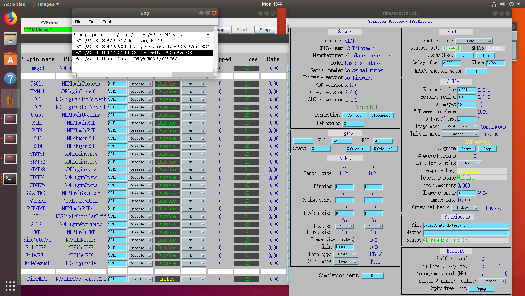

I attach screen shots with the requested information, as best I can.
Also screen shot of hdvview showing the resulting file, no attribute nodes (quite unlike the screen shot you sent me!).

  • NB, data visualisation with ImageJ works for me with the ADURL module with the values given, but fails for the SimDetector module (with or without attempting to use HDF5).
Did you look at the ImageJ log file?
Please send screen shots of the following:
  • simDetector main screen
  • simDetector setup screen
  • commonPlugins screen
  • EPICS_AD_Viewer ImageJ screen
Mark

b. When I run the sim detector and try to visualise with ImageJ, I get green on both 13SIM1:image1 and 13SIM1:image2.
    But, I don’t get any image displayed for either.
c. I note an error:
    NDPluginDriver::connectToArrayPort Error calling pasynManager->connectDevice to array port FFT1 address 0, status=3, error=asynManager:connectDevice port FFT1 not found.
    Could my (b) have anything to do with this error?
    I understand that image2 would be the FFT of the simulated data generated for image1?
