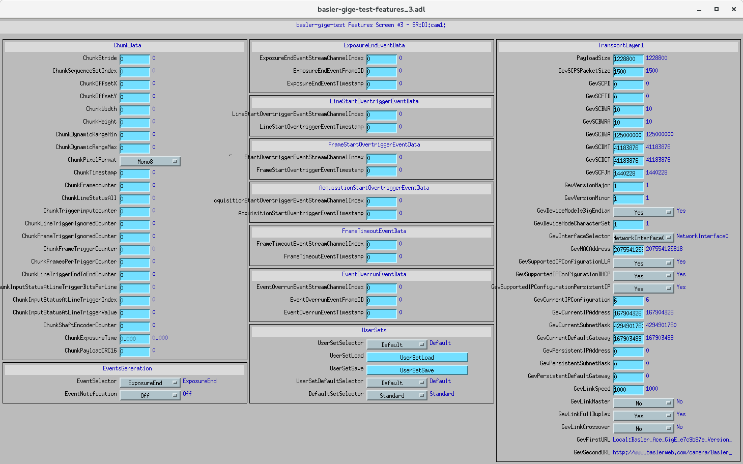

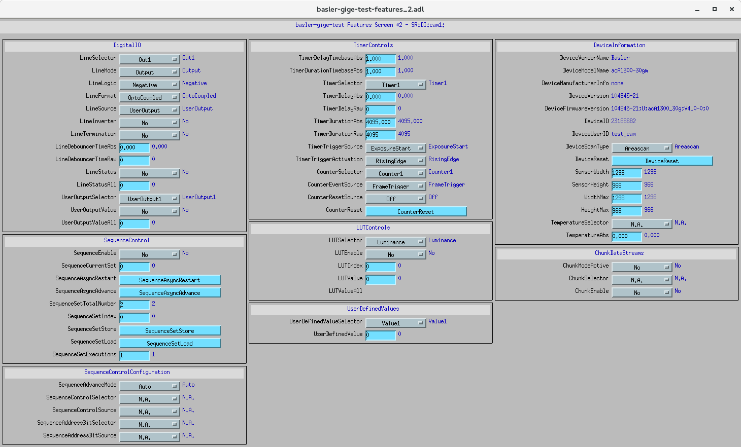

Hello Mark
Attached is the Genicam features GUIs. I noticed that I was loading the NDStdArrays plugin using “NDStdArraysConfigure” and a bunch of other templates from ADCore and NDDriverStdArrays, so I unloaded the plugin and the IOC seems to acquire images so far smoothly, I did a quick run today and It did like 350K frames and more at 32 fps with 11 frame error and few thousands frame underruns. Seems like an issue with the ND plugin.
