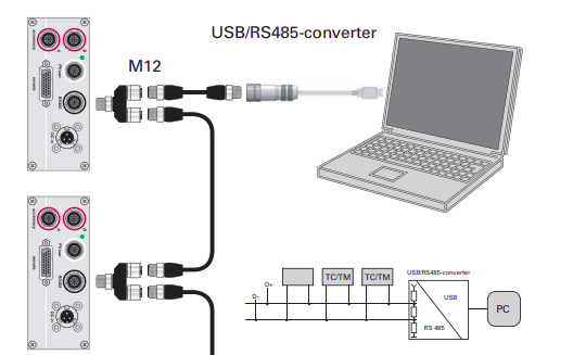

Hi, Florian. Thaks for your answer!
The db and proto files for the conenction with TC 400 would be very useful indeed. Im grateful if you can send them to me.
You said both the TCP350 and the TC400 are connected to the computer... Are you using some kind of cross-linking connection like the one in the attached picture, but with the TCP350 in the place of one of the TC400? Is it safe to do it without generating any kind of conflict?
Cheers,
Marco

we operate the HiPace300 with a TCP350 controller and via a TC400 Controller.
In our lab both were connected via RS485 to our PC and controlled via StreamDevice + Asyn
I can send you the protocol and DB files, if you want.
