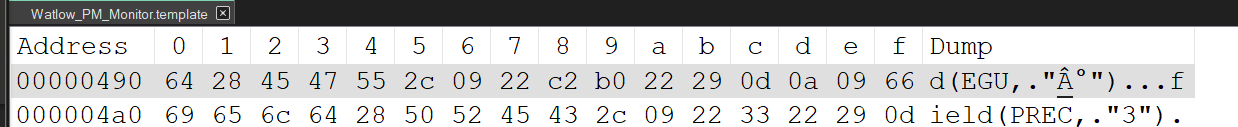

Looking at Watlow_PM_Monitor.template in Notepad++ with the HEX editor installed, I see that it is already showing 0xC2 0xB0 (screenshot attached).
When I look at the Windows ANSI (windows-1252) code page, I see that 0xC2 is for Latin Capital letter A with circumflex, and 0xB0 is degree sign.  So that explains why I’m seeing the double characters in Phoebus, though not what to do about it.
