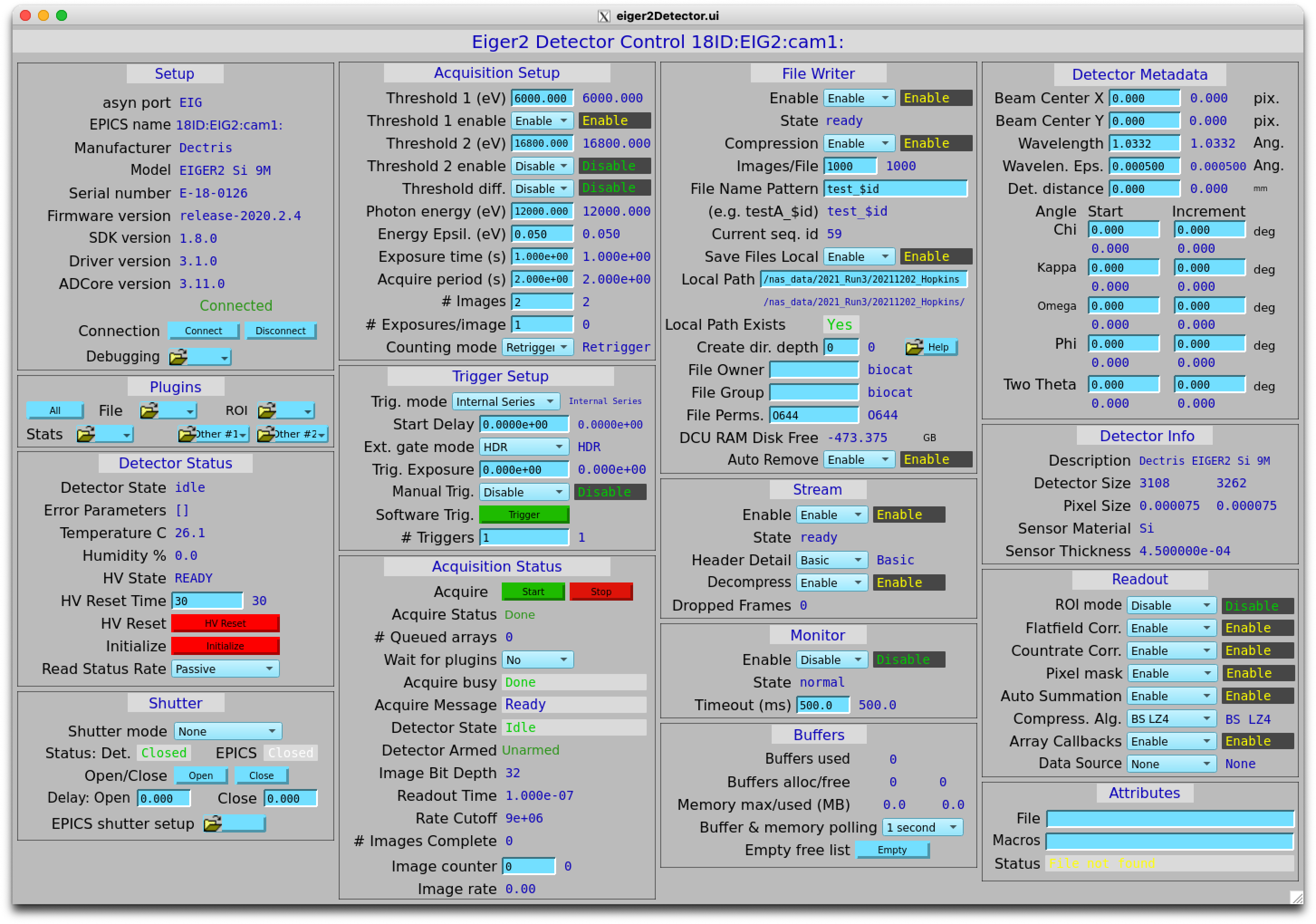

We recently got an Eiger2 XE 9M and I've been using AreaDetector to control it. So far, if I'm just using AreaDetector by itself everything works great (thanks for that!). In the long run what I would like to do is use AreaDetector to control the exposures, but use my own program to read the Eiger Stream over zmq and process the data in real time. According to the documentation this should be possible.
However, when I run the Eiger from AreaDetector with DataSource set to None, as specified in the documentation, my zmq client only receives half of the messages, which is what I would expect with two PULL clients connected to a single PUSH client. For example, if I take two images, I see only frame 0 and the dseries-end messages but not the dheader or frame 1 messages. If I collect images under the same conditions without the IOC running (e.g. just stop the IOC and send an arm and trigger command directly to the api with all settings left the same) I get all of the expected messages.
I'm wondering if there's some setting I've missed (see attached screenshot of the caQtDM window) or if this is a bug.
Also, as a side note, you'll see in the caQtDM window that the DCU RAM Disk Free is reporting a very wrong number, I suspect it's an overflow error. If I query buffer_free (which I assume is that that is), I get the following:
{"access_mode":"r","unit":"B","value":85402976256,"value_type":"uint"}
