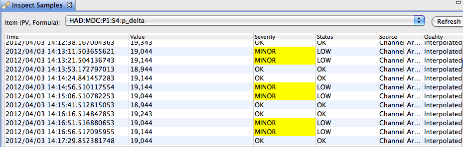

Hi,
when looking at archived data with the CSS trend plot "Inspect Samples" tool we
found some surprises in the archived data:
It looks like the interpolated samples show the wrong Severity and Status.
When I export the raw data from the archiver all value/status/severity are ok (in this case the LOW limit was set at 20).
See screen shot of CSS(3.1.0.20120201):
