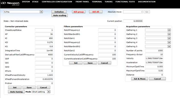

After rebooting the controller I am able to successfully use the Newport web interface to initialize, home and move the stage.  However when I try and move the stage with the Motor record I am seeing strange behaviour.

I did an asyn trace and after starting up the motor records appears to be passing in the wrong values for the limits.
2013/11/01 14:03:31.880 motorAxisSetDouble[0,0]: error performing PositionerUserTravelLimitsSet for high limit=0.000000, status=-17
2013/11/01 14:03:31.888 drvMotorAsyn::writeFloat64, reason=4, value=0.000000
2013/11/01 14:03:31.895 devMotorAsyn::asynCallback: SMTR1608-9-B20-05:brag pasyn{Float64,Int32}->write returned
2013/11/01 14:03:31.904 motorAxisSetDouble[0,0]: error performing PositionerUserTravelLimitsSet for low limit=0.000000, status=-17
Upon initialization I am pushing in a movement from the home position of 6.000 to 8.54439294393059, however the motor is passing in a value below the low limit for an absolute move and is therefore not moving.
2013/11/01 14:03:36.041 SendAndReceive unexpected response =-17,GroupMoveAbsolute (S.Pos,1.398175069718e-312),EndOfAPI

What is even stranger is that the velocity and acceleration are then set to values much smaller than then should be (e-312)
I am sure I must have something configured incorrectly.  At this point it appears that the problem is associated with something configured incorrectly with the motor record.  I would greatly appreciate any feedback or insight anyone can provide.
