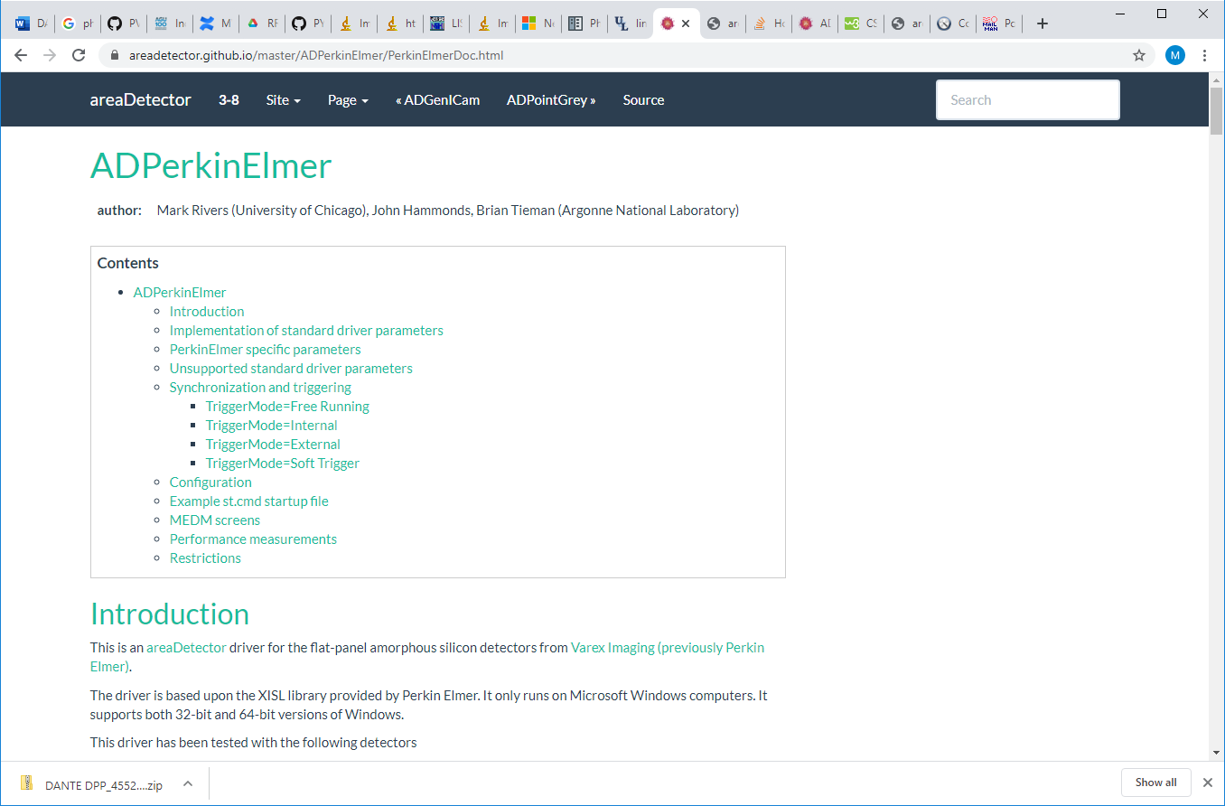

The line of code that is restricting the max width is in line 220 of _static/basic.css:
div.body {
    min-width: 450px;
    max-width: 800px;   <--------
This appears to be provided by the sphinx theme.
I disabled this line (using inspect element in firefox on the top level div, similar tools exist in chrome) and the page seems to work as expected. You could increase that limit in the theme_overides.css file to get around it, although it is odd that it works differently on your local machine to github.io.

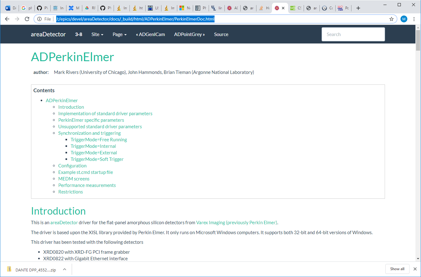

I am having an issue where the tables look good when I build and serve the documents on my local machine, but they do not look as good on github.io.  The problem is the maximum width of the page.
This is what a page looks like when I build and display on my local machine, where it looks OK.  As I increase the width of the browser window the page gets larger up to some width, and then stops changing.  When I change the min-width in the theme_override.css it does not seem to make any difference.
This is what the same page looks like on areadetector.github.io.  I am displaying it in the same browser session, just a different tab.  Note that the page is much narrower, even though the browser window is the same width.
