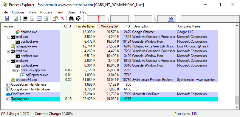

2) Microsoft has a nice "Process Explorer" application that is a more powerful version of Task Manager.  You can find it with Google and download it.
caRepeater shows up there, while it does not show up in Task Manager.  Note that in this case it is nested under PointGreyApp.exe, which is my IOC.
I suspect perhaps the reason it is not showing up in Task Manager is that Task Manager may only be showing nested processes 2 deep, rather than 3 deep?
