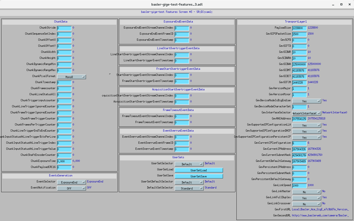

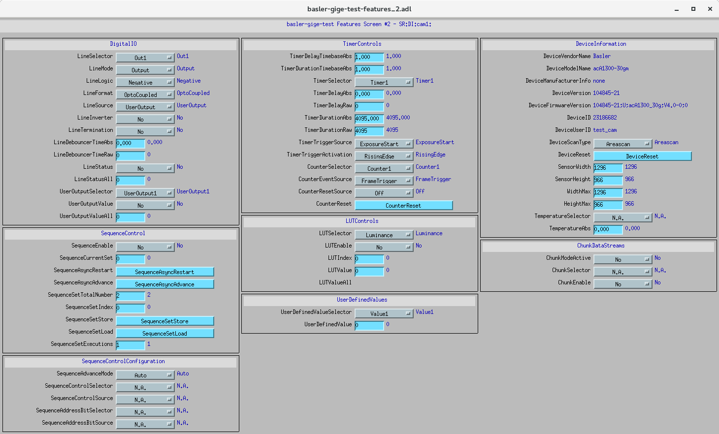

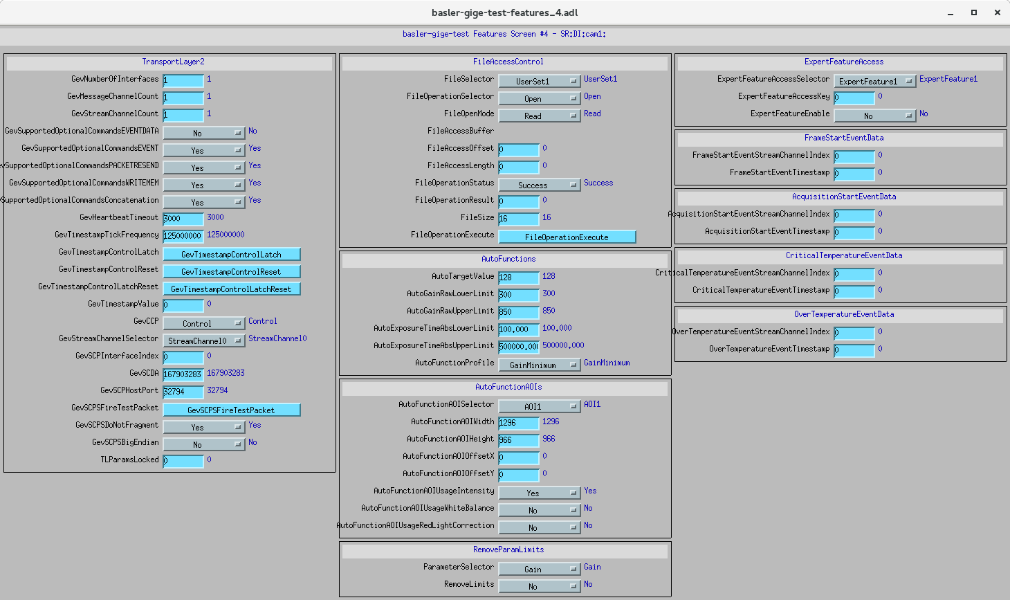

Hello Mark
Attached is the Genicam features GUIs. I noticed that I was loading the NDStdArrays plugin using “NDStdArraysConfigure” and a bunch of other templates from ADCore and NDDriverStdArrays, so I unloaded the plugin and the IOC seems to acquire images so far smoothly, I did a quick run today and It did like 350K frames and more at 32 fps with 11 frame error and few thousands frame underruns. Seems like an issue with the ND plugin.

Hello Mark
One messed up sentence, I meant "from EPICS" of course :)
The thing is, FrameRateEnable_RBV is always "NO" and I can't set it through its drop down menu. AcquireTime (Or the exposure time) is set to default value of 0.009, increasing it will give slower rate as expected (0.1 will give array rate of 10) but still can't set the frame rate. The camera normally is running with array rate of 32 but ImageJ is still seeing only 1 FPS.
I am using NDPluginStdArrays and callback time, array rate and byte rates are all set to 0. Attached are the required snapshots.
Thanks.
Abdalla.

Please send screen shots of the following when you believe the camera is acquiring at 32 frames/s.
- Your main ADAravis.adl screen
- The screen with the plugin you are using for the viewer, i.e. NDStdArrays.adl or NDPva.adl
- The camera-specific *-features_*.adl screen that contains the AcquisitionFrameRateEnable or  AcquisitionFrameRateEnabled PV
