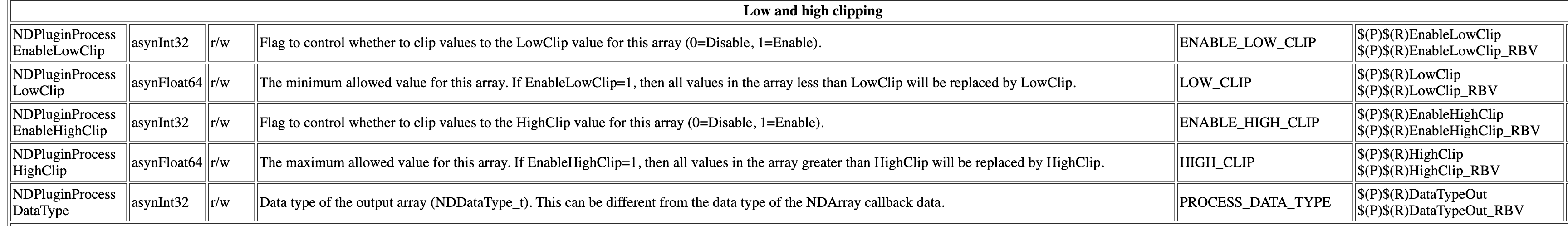

Maybe you could try enabling the Low/High Clipping.
I am not 100% sure if it will work but at least it is something to try.
