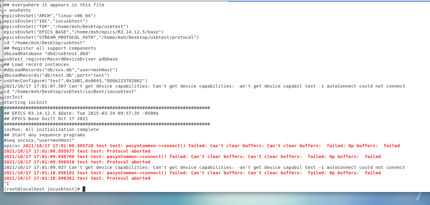

Hello,
I try to make epics control system for dg812(Rf signal generator of RIGOL).
The dg812 supported usb commuincation but the protocol is usbtmc so I used drvAsynusbtmc module of asyn.
However, I faced  some error like below.
I did the test in centos7 enviroment and the version of asyn is 4-26 and the version of base is 3.14.12.5 .
I also did the test with rasberrypi3 enviroment with same asyn and base version but it shows same error message.
'Can clear buffer ~' and 'Can't get device capabilities ~'
The most strange thing is about usb mount. When I plug in the usb cable and check the usb mount at /dev, I can check that the usb is succesfully mounted with name 'usbtmc0'.
However, after I run epics and see the above error, the usb is diconnected so I can't see the 'usbtmc0' at /dev directory.
 That thing happens at centos 7 environment and also in rasberrypi enviroment.
Can you give me some advice about this error?
