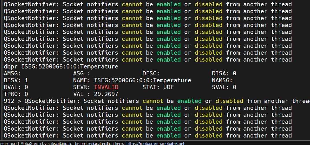

I added some screens for your consideration, as you can see the communication is okay and the return values, I can confirm are correct, but this warning “QSocketNotifier: Socket notifiers cannot be enabled or disabled from another thread” keeps on popping up. I have disabled the embedded IOC and tested before launching this one that the pv are no longer connected.

From: Florian Feldbauer <florian at ep1.ruhr-uni-bochum.de>
Sent: Monday, May 29, 2023 10:49 AM
To: Yann Mandza <yann.mandza at ess.eu>; tech-talk at aps.anl.gov
Cc: Jens Römer <j.roemer at iseg-hv.de>
Subject: Re: Issues with epics module and ISEG HAL service libraries
Hey Yann,
the communication with the socket does not happen within the device support, but within the isegHal library.
Tbh I do not really understand the problem you have. The EPICS IOC running on the crate controller uses the same device support.
So if muliple threads within EPICS cause the error, it should happen in that IOC as well, but it doesn't.
So I guess the problem comes from somewhere else. Are you running multiple IOCs/programs accessing the isegHAL?

Am 29.05.2023 um 10:39 schrieb Yann Mandza via Tech-talk:
Hey Florian, thanks for your quick feedback,
“as for the AO record: The initialization failes, because the "Quality" of the iseg items returns 000 (=ISEG_ITEM_QUALITY_INVALID)
Maybe the module you are using does not support setting the RampSpeed and thus the isegHal return INVALID qualtiy for it.
That would explain, why it is the only record producing this error.“
I believe the issues is with my hardware config, but I only show the output of one AO record, many of those AO shows this error, I will first get the config right and see if this  “INVALID quality” is clear and the initialization works.
When it comes to Qt, I only tied to follow the source of the problem. There is an issue of epics thread (reading/writing) to the socket as once since that socket is creating as shared resource statically should it not be protected?
I was asking if the device support could handle this? Is there a way to know which epics thread make the call to the driver methods? At init all records call the devIsegHalInitRecord method which call the driver method iseg_getItem which internally make read and write call to the socket.
Does the DB record initialization process handle each record in its own thread? Who can help me understand this init process?
Perhaps having a thread that solely access the socket working as a server for those epics thread would make it safe?
Regards,

Hello all,
I have a ICSMINI 2 box from iseg am trying to interface to via the HAL services utilities using HAL service libraries from iseg, I was able to recompiled for my system.
So far I tried to connect to the box using the provided example and it worked.
However I tried the epics module from florian  https://github.com/ffeldbauer/devIsegHal, so i could disable the embedded IOC and run mine outside.
I was able to compiled the module and get the IOC connected to the box. However I’m having two main issues.
1 -  error at record initialization for AO record
ISEG:7200081:0:32:VoltageRampSpeed: Error while reading item property '0.32.VoltageRampSpeed' (Q: 000)
recGblRecordError: ao: init_record Error (514,11) PV: ISEG:7200081:0:32:VoltageRampSpeed ( is this a result from the above? Then sorting out the above should clear this error)
it’s strange because only AO return this error.
I read on the deviseghal GitHub page that AO record were added to the polling thread that also handle I/O interrupt.
I wonder why that would be?
This excerpt is from the page
“It is possible that control parameters change during operation. For example, if a trip occurs the corresponding setON bit in the channel control register will be set to 0.
These changes are monitored by devIsegHal through a polling thread. Each output record (except for stringout records) is automatically registered to this thread and their values are checked for updates on the isegHAL.
If a value has changed the VAL field and timestamp of the record will be set to the new values”
I’m a bit confused why output record would need that.
2- Qt Socket Library return this warning “QSocketNotifier: Socket notifiers cannot be enabled or disabled from another thread", it seems the IOC starts several threads to read/write information to the iseg system.
One can trace this issues till the writeReadSynchronous method within the isegHal-service library. I used QT5 to compile the library.
Can the device support protect against this or should iseg update their code to handle multi thread access to the socket?
