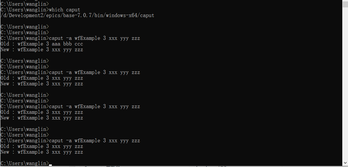

On Thu, 14 Dec 2023 at 09:48, Wang, Lin <[email protected]> wrote:
A regular IOC with the following waveform record works properly with the caput CLI comes with EPICS 3.14.12.8 or EPICS 7.0.7.
record(waveform, "wfExample")
        field(DTYP, "Soft Channel")
        field(FTVL, "STRING")
        field(NELM, "3")
        field(INP, ["aaa", "bbb", "ccc"])
Hm...
Can you double check if that is a single element ("xxx yyy zzz") or three elements ("xxx", "yyy", "zzz") in the record? (Might look the same on the command line.)
Cheers,
~Ralph
