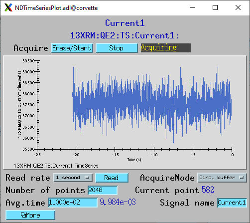

I have attached 2 screenshots showing what the time series should look like.
NDPluginTimeSeries.png shows the time series control screen.
  • This plugin gets called each time one averaging period has elapsed.  It passes an array of dimensions 11xN.  11 is the number of different data items (current1, current2, position1, position2, etc.)  N is the number of points being averaged in the main driver.
  • The UniqueID and Time stamp in this window should be updating as new data arrives.
  • The Time link tells the plugin where to get the time between points.  This link should have the CP attribute so it updates when the driver sampling time changes.
  • The Averaging time controls the number of points that are averaged before plotting them.  It is basically the same as time/point, and so # Average is 1 in this example.
  • AcquireMode controls whether the plot is circular buffer (continuous) or fixed length (stop after #Time points points.
NDTimeSeriesPlot is the plot.  In this case it is Current1 in Circular buffer mode.
Let me know if you still have questions/problems.

Thank you.  You pointed me in the right direction for the updates of “Current” et al.  The IOC never set # To Average; I fixed that in the IOC, and now the values update according to the Averaging Time.
What is the behavior of the time series plots supposed to be?  I try acquiring, and I get the number of samples I say to acquire when I click the Erase/Start button, but I do not see anything on the graphs.
