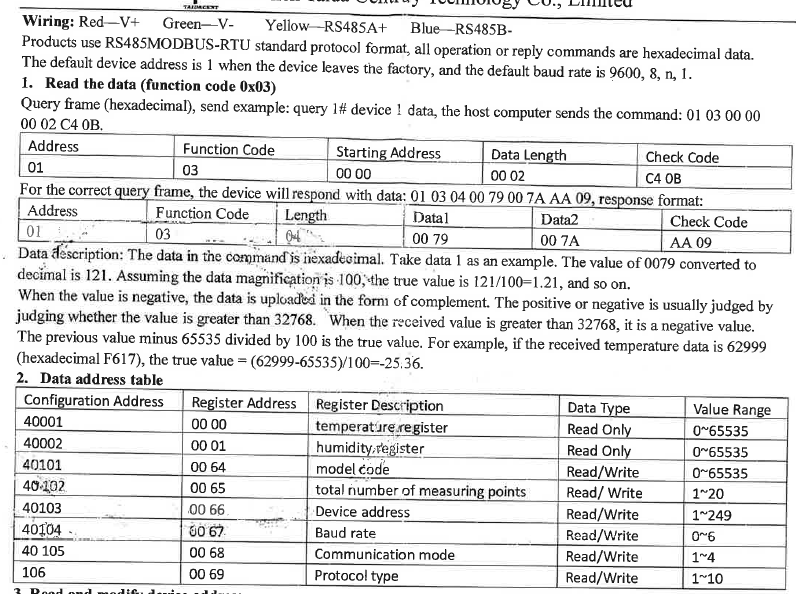

Hi Modbus expert,
I am working on a Modbus RTU Temp & humidity sensor. Here is the driver configuration and error message after running the IOC. It seems the write/read length has error.
I am new to Modbus and don’t know how to make the correction. The last picture is the device protocol.
Susheng Xin
