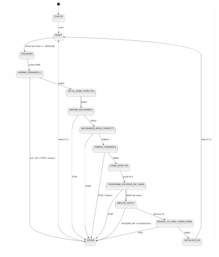

An alternative, low-effort, approach that might work as a “quick
look” at the states in your SNL file, is to ask ChatGPT to
generate a PlantUML (or perhaps Mermaid) diagram for you.
Just for fun I asked the GPT-4o model to visualize the states
in the homing procedure that initializes one of our
stepper-motor controlled range-shifter devices.
It seems to have made a reasonable job of it (see attached
screenshot), though not as detailed as the diagram I made
years ago, laboriously, using a UML modelling tool.
Just throwing the idea out there, although most of you are
probably already aware of it…
