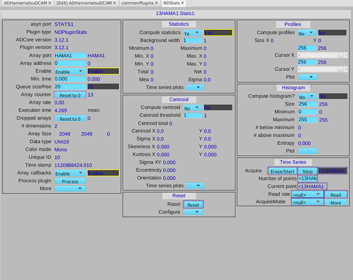

I will attach the images as asked but after running it both with the other ADHamamatsu EPICS module that we had here and with the manufacturer's software and getting the same result, we are suspecting some problems in the hardware or firebird card, not anything wrong with the new EPICS module.
The array counter increases for the plugins, but the statistics doesn't seem to point to any pixel being actually activated.
I sent a message to the manufacturer and will report if I manage to advance.

Please send screenshots of the following when the camera is acquiring:
  • Main ADHamamatsuDCAM screen
  • commonPlugins screen showing all plugins
  • Enable the Stats5 plugin, set its array source to HAMA1 and send a screen of that plugin.
