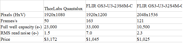

I see the HTML table did not come through tech-talk well so I have attached it as an image.
Mark

Here is a comparison of that camera with 2 FLIR cameras:
        ThorLabs Quantalux
        FLIR GS3-U3-23S6M-C
        FLIR GS3-U3-32S4M-C
Pixels (HxV)
        1920x1080
        1920x1200
        2048x1536
Frames/s
        50
        163
        121
Full well capacity (e-)
        23,000
        33,000
        10,500
RMS read noise (e-)
        1.5
        7.0
        2.3
Price
        $3,172
        $1,045
        $1,025
So both of the FLIR cameras are faster, have more pixels, and are cheaper.  One has a 50% larger full-well capacity than the ThorLabs, the other is 50% smaller.  One has ~4 times the read noise, the other about 50% more.  But even 7e- read noise is only significant if the pixels have fewer than about 50e- total; if they have more than 50- then the shot noise (sqrt(50)) dominates.  Is this a very low-light application?
