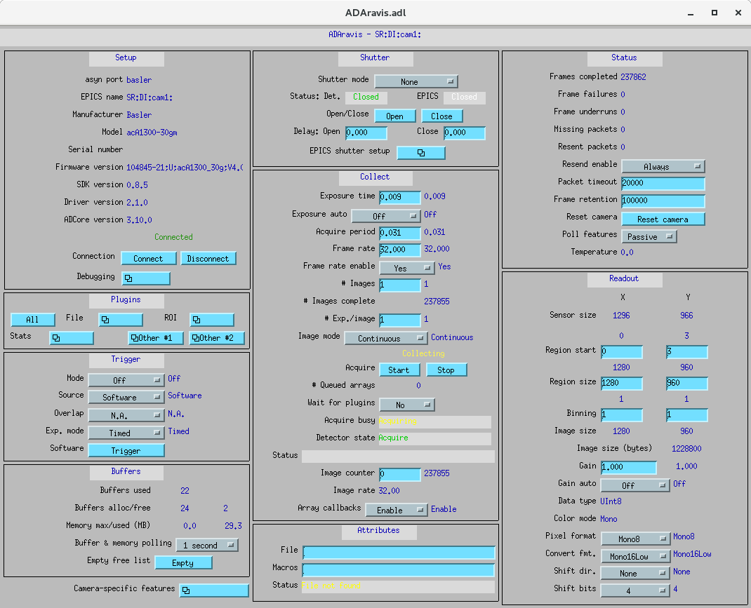

You did not send the screen shot of the main ADAravis screen.  Please do that when the camera is capturing.
Loading the plugins with commands like NDStdArraysConfigure has no effect on performance.  However, enabling those plugins can affect performance.  You should load them all, but only enable the ones you need.  Please also send a screen shot of the commonPlugins.adl screen.

Attached is the Genicam features GUIs. I noticed that I was loading the NDStdArrays plugin using "NDStdArraysConfigure" and a bunch of other templates from ADCore and NDDriverStdArrays, so I unloaded the plugin and the IOC seems to acquire images so far smoothly, I did a quick run today and It did like 350K frames and more at 32 fps with 11 frame error and few thousands frame underruns. Seems like an issue with the ND plugin.

Please send screen shots of the following when you believe the camera is acquiring at 32 frames/s.
- Your main ADAravis.adl screen
- The screen with the plugin you are using for the viewer, i.e. NDStdArrays.adl or NDPva.adl
- The camera-specific *-features_*.adl screen that contains the AcquisitionFrameRateEnable or  AcquisitionFrameRateEnabled PV
