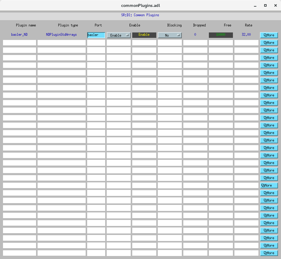

Hi Mark
Attached are the screenshots now while the camera is running. The PC hosting the IOC is an i7-7700 (4 Cores, 8 threads) with 8GB RAM.

The frame queue size for the plugin just controls how many frames it buffers before it begins to drop frames.  If the plugin cannot keep up with the frame rate then it will eventually drop frames.  The value can be changed a run-time.  Please send a screen shot of commonPlugins.adl, which is the Plugins/All menu.
What are the specs on the computer hosting the IOC, how many cores and how much memory?  Please also send the output of "top -H" when the camera is running at 32 frames/s.

I think the problem is the frame queue size value passed to "NDStdArraysConfigure" in the IOC startup script. It had a value of 100, now I could not figure out how to choose a value so I put an arbitrary value of 1000 and the acquisition is working good (230K frames so far). How do I choose a value for the frame queue size?

Attached is the Genicam features GUIs. I noticed that I was loading the NDStdArrays plugin using "NDStdArraysConfigure" and a bunch of other templates from ADCore and NDDriverStdArrays, so I unloaded the plugin and the IOC seems to acquire images so far smoothly, I did a quick run today and It did like 350K frames and more at 32 fps with 11 frame error and few thousands frame underruns. Seems like an issue with the ND plugin.
