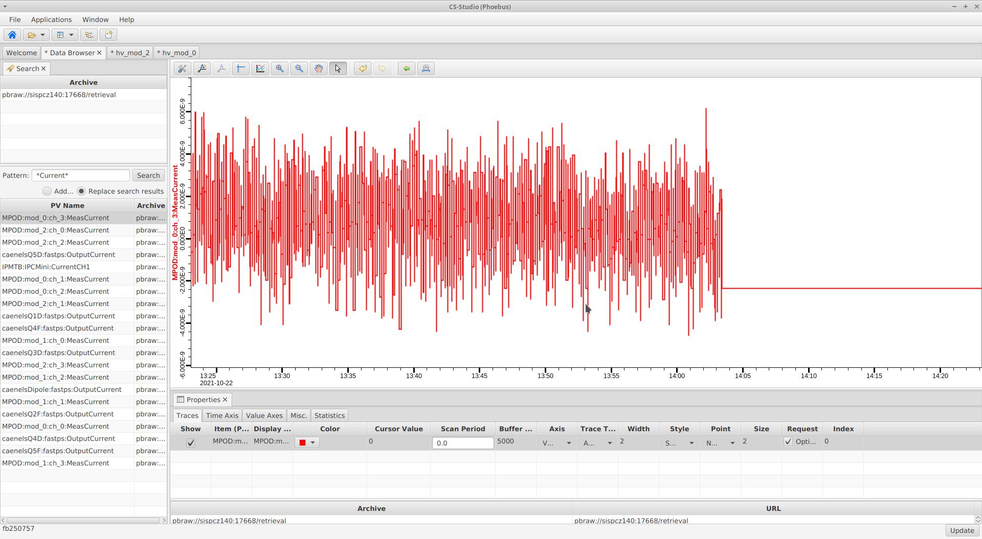

I would like to perform live plotting data with the Phoebus Data Browser from an Archiver Appliance instead of PVs. But it does not work as intended. I have to manually refresh the plot in order to get new data, otherwise the curve stuck with the last value (as shown in the screenshot). I tried to set scan as periodic instead of monitor but the same behavior is observed.
Is it possible to do that with Data Browser? Maybe I missed something in my Phoebus/Archiver configuration?
