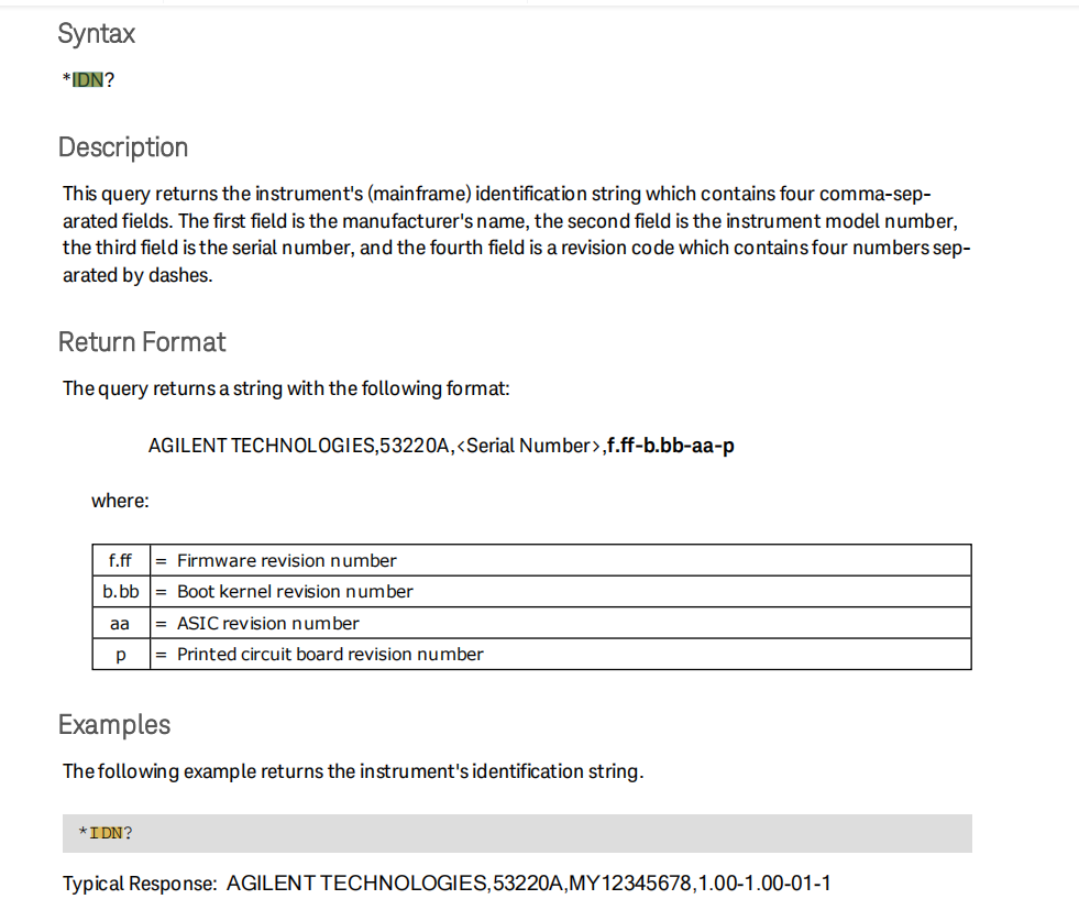

The description of the command of *IDN? is in the attachment.
