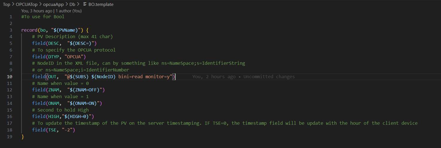

I’m currently using the OPCUA epics module (with the open62541 librairy) to communicate with a PLC Siemens s7-1500 and I would have a question about the process of a BO record at initialization.
With OPCUA, it seems possible to process a record at the initialization with defining the option bini inside the OUT field :
cid:image001.jpg@01DB4BCE.41873DD0
So I defined it in my bo template :
cid:image003.jpg@01DB4BCE.41873DD0
But my BO are still not processing during the IOC init. It fonctionne well with the input record (AI and BI). Maybe I didn’t understand well the bini option ?
Does someone already had this problem and have a solution to propose ?
Sinceraly,
cid:image010.png@01DB4C71.7DCE0230
