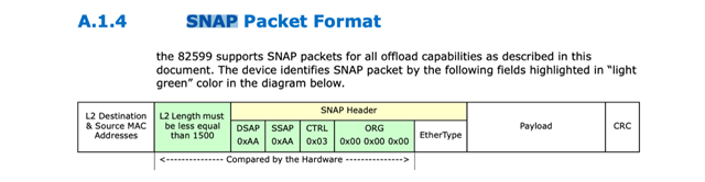

P.S.
I found this in 82599-datasheet-v3-4.pdf:
