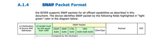

tcpdump agrees with the driver debugging printout, the second packet was sent multiple times but no response was seen. Here is the tcpdump output.  The first packet is the 108 byte message sent from Linux to the device, and the second packet is the 72 byte response received about 50 ms later.  Then there are 3 172-byte messages sent by Linux with no reply.  These messages are sent 1.00 seconds apart because that is the timeout.
11:30:18.680030 3c:fd:fe:a3:f2:58 (oui Unknown) > 00:00:af:00:03:ed (oui Unknown), 802.3, length 116: LLC, dsap SNAP (0xaa) Individual, ssap
SNAP (0xaa) Command, ctrl 0x03: oui Unknown (0x0000af), pid Unknown (0x5034), length 108:
        0x0000:  aaaa 0300 00af 5034 f266 03af 0100 0101  ......P4.f......
        0x0010:  0000 0000 0000 0000 0000 0000 0000 4c00  ..............L.
        0x0020:  0000 0000 0000 0000 4400 0000 0100 1600  ........D.......
        0x0030:  2000 0000 0001 1011 2021 3031 4041 5051  .........!01@APQ
        0x0040:  6061 7071 8081 9091 a0a1 b0b1 c0c1 d0d1  `apq............
        0x0050:  e0e1 f0f1 0000 0000 0000 0000 0000 0000  ................
        0x0060:  0000 0000 0000 0000 0000 0000 0000 0000  ................
        0x0070:  ffff ffff                                ....
11:30:18.733989 00:00:af:00:03:ed (oui Unknown) > 3c:fd:fe:a3:f2:58 (oui Unknown), 802.3, length 80: LLC, dsap SNAP (0xaa) Individual, ssap S
NAP (0xaa) Command, ctrl 0x03: oui Unknown (0x0000af), pid Unknown (0x5034), length 72:
        0x0010:  3cfd fea3 f258 636f 7276 6574 7465 2800  <....Xcorvette(.
        0x0020:  0000 0000 0000 0000 2000 0000 0200 0900  ................
        0x0030:  ffff ffff 02f4 02f7 ffff 02f6 ffff ffff  ................
        0x0040:  02f2 ffff ffff ffff ffff ffff ffff ffff  ................
11:30:18.734415 3c:fd:fe:a3:f2:58 (oui Unknown) > 00:00:af:00:03:ed (oui Unknown), 802.3, length 180: LLC, dsap SNAP (0xaa) Individual, ssap
SNAP (0xaa) Command, ctrl 0x03: oui Unknown (0x0000af), pid Unknown (0x5034), length 172:
        0x0000:  aaaa 0300 00af 5034 f266 03af 0100 0201  ......P4.f......
        0x0010:  0000 0000 0000 0000 0000 0000 0000 8c00  ................
        0x0020:  0000 0000 0000 0000 8400 0000 0100 1500  ................
        0x0030:  0100 0000 2000 0000 0000 0000 0000 0000  ................
        0x0040:  0000 0000 0000 0000 0000 0000 0000 0000  ................
        0x0050:  0000 0000 0000 0000 0000 0000 0000 0000  ................
        0x0070:  0000 0000 0000 0000 0000 0000 0000 0000  ................
        0x0080:  0000 0000 0000 0000 0000 0000 0000 0000  ................
        0x0090:  0000 0000 0000 0000 0000 0000 0000 0000  ................
        0x00a0:  0000 0000 0000 0000 0000 0000 0000 0000  ................

I thought also about the MTU right away, just like Michael. With 10Gbit/s Ethernet this is 9000 bytes
as default and not 1500 bytes as with the 1Gbit/s Ethernet.
We had similar problems with a small Omron PLC. It only supported 10Mbit/s and it could handle
UDP even only with a MTU of 768 bytes. Omron's internal buffer was simply designed too small.
Here we had to connect a router to make it work.
Heinz
P.S.
I found this in 82599-datasheet-v3-4.pdf:
