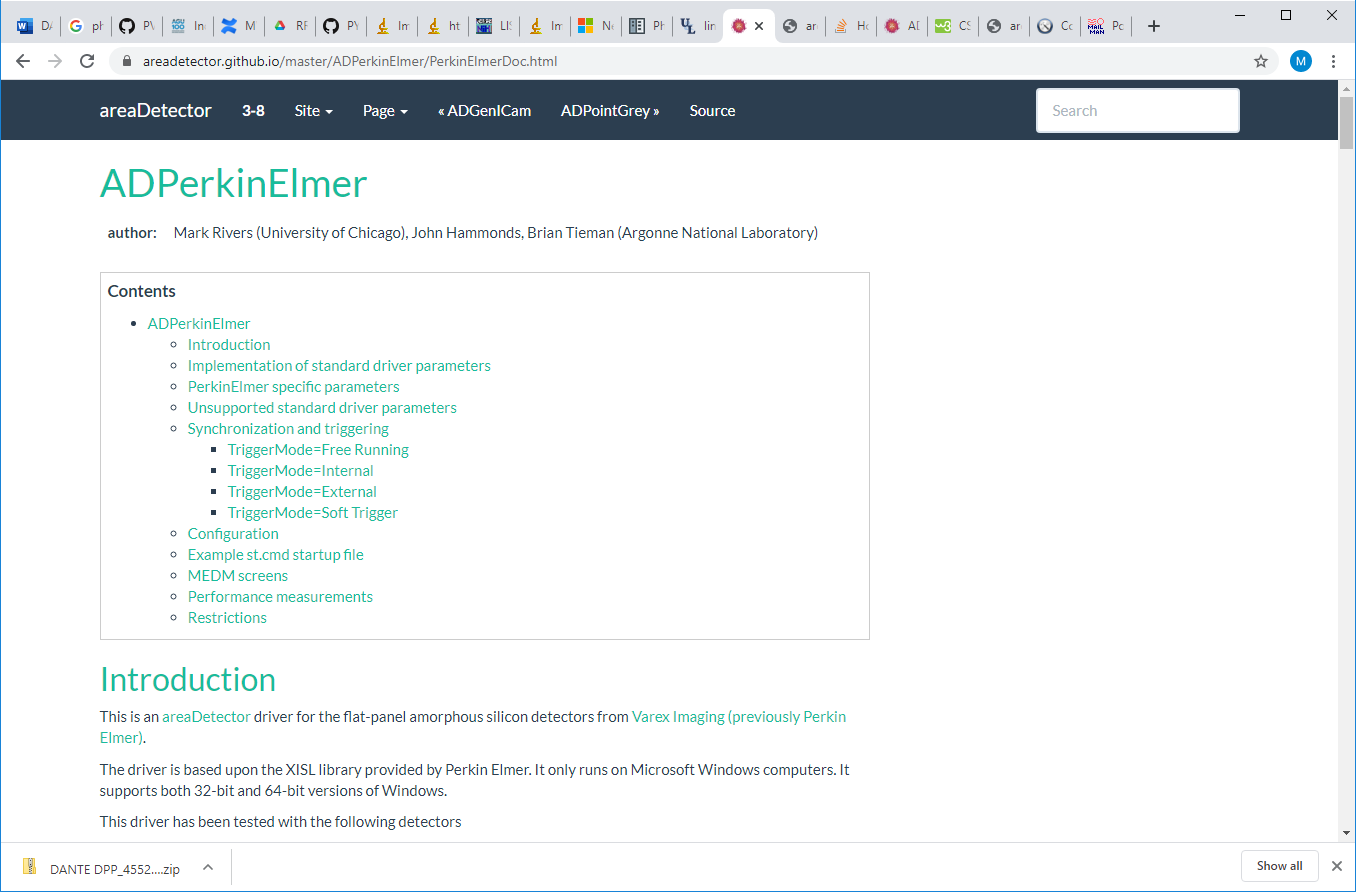

Ø  Yes, my local machine (corvette) is using Sphinx 1.8.5, rather than 1.8.4.
I just updated the requirements.txt file to use Sphinx 1.8.5 rather than 1.8.4.  The Travis build is thus now using Sphinx 1.8.5, and it says that at the bottom of the pages on areadetector.github.io.
However, the page from areadetector.github.io is still only 800 pixels wide, while it is 1170 wide when I run Sphinx 1.8.5 locally.
This is also using the div.body block in theme_overrides.css that should be increasing the 800px to 1200px, but that does not seem to help.
Mark

Yes, my local machine (corvette) is using Sphinx 1.8.5, rather than 1.8.4.  However, on the local machine /_build/html/_static/basic.css does contain the same lines that cause the display to be only 800 pixels wide on github.io.
div.body {
    min-width: 450px;
    max-width: 800px;
But for some reason when displaying locally that 800px limit is not enforced?
Mark

I am having an issue where the tables look good when I build and serve the documents on my local machine, but they do not look as good on github.io.  The problem is the maximum width of the page.
This is what a page looks like when I build and display on my local machine, where it looks OK.  As I increase the width of the browser window the page gets larger up to some width, and then stops changing.  When I change the min-width in the theme_override.css it does not seem to make any difference.
This is what the same page looks like on areadetector.github.io.  I am displaying it in the same browser session, just a different tab.  Note that the page is much narrower, even though the browser window is the same width.
My questions:
-          Why is the .rst file being displayed differently on github.io versus my local machine?  Both pages eventually stop growing wider as the browser window width is increased, but that limit is much narrower on github.io than on my local machine.
-          Is there a setting I can change to make the page grow wider than the current maximum as the browser window width is increased?
