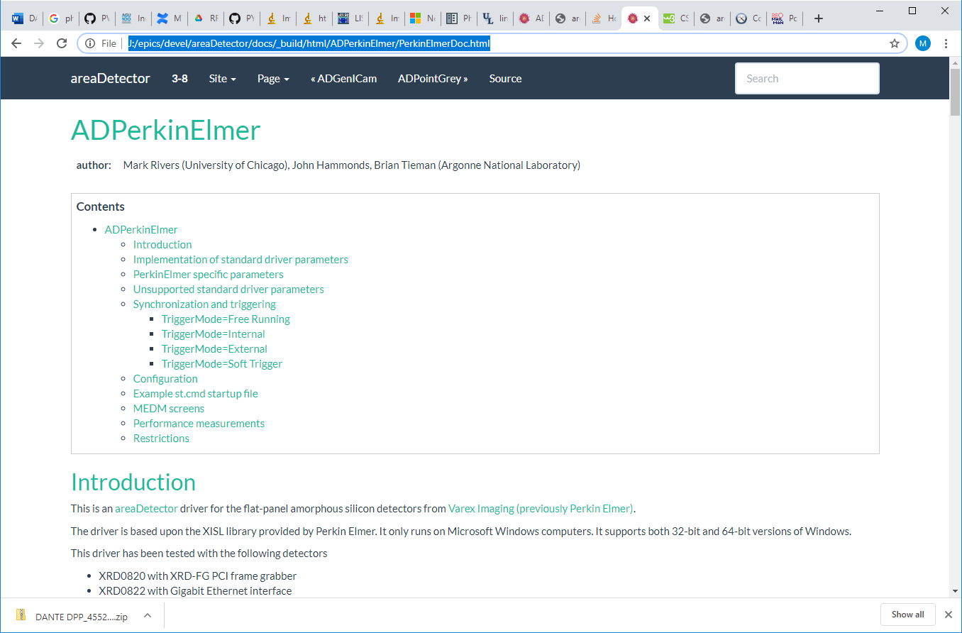

Thanks to Stuart Wilkins much of the EPICS areaDetector documentation has been converted from raw HTML to ReST, using Sphinx to generate Web pages on areadetector.github.io.

I am having an issue where the tables look good when I build and serve the documents on my local machine, but they do not look as good on github.io.  The problem is the maximum width of the page.
This is what a page looks like when I build and display on my local machine, where it looks OK.  As I increase the width of the browser window the page gets larger up to some width, and then stops changing.  When I change the min-width in the theme_override.css it does not seem to make any difference.
This is what the same page looks like on areadetector.github.io.  I am displaying it in the same browser session, just a different tab.  Note that the page is much narrower, even though the browser window is the same width.
