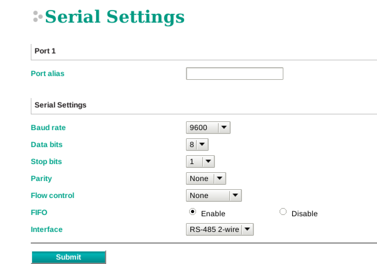

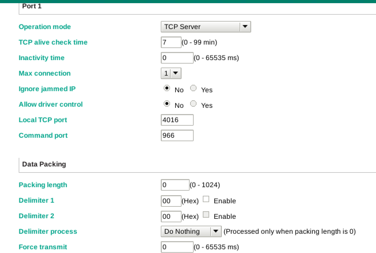

The model is Moxa NPort 5150A. The moxa is set to "terminal server" mode. I attached moxa screenshots, the traceOutput.txt file, and the db and protocol files.
Alex

What model terminal server are you using and what "mode" have you configured the port on the terminal server?  Can you open the Web interface to the terminal server and send a screen shot?

The device does not have an ethernet port. For communications it has a serial port and this is connected to a Moxa terminal server. It is an ascii device. The baud rate on the Moxa terminal server is set to 9600. The baud rate on the device should be set to 9600 as well, but I am not near the device to check. If the baud rate on the device did not match the terminal server though, I would think that no command would go through at all, but for this device I am able to send and receive commands.
For example, the command to read temperature is:
*01X01
And the device responds with:
01X01025.2
The 25.2 at the end is the temperature in celsius.
I just tried telnetting into the device and typing this command and it worked. I did, however, get a continuous stream of unwanted characters randomly pop on the screen as I was typing the command. But after I hit enter the response from the device was fine (01X01025.2). I did it again and got 01X01023.5, which also looks good.
Ideally, these devices would only respond to commands, and never send unsolicited characters. But some of these devices send unsolicited and unwanted characters for unknown reasons.
Temperature reading PVs work as well, but only when I first start the IOC.
For example, the value was stuck at 25.1 since an hour ago, but I restart the IOC and the value is now 22.1. So it looks like the communication sometimes works, but then the PVs get permanently "jammed" by the unwanted characters.
The question I have is whether it is technically possible at the IOC level to prevent these unwanted characters from permanently "jamming" the PVs.

What type of interface are you using to the device?  Does the device itself have an Ethernet port, or are you using a terminal server, with a serial connection to the device?
What type of communication does the device use, ASCII or binary?  You are getting single character messages that are more \377 which is 8 bits that are all 1.  What type of messages do you expect, can you give an example?  The output you sent was only those single non-ASCII characters.  Do you ever get normal ASCII characters?
If you are using a terminal server then I suspect you may have the baud rate or parity configured wrong.
I notice that asynTrace output shows only read operations, no write operations.  Does your device send unsolicited messages, or should it only answer when sent a command?
Please generate a minimal startup script that generates the problem and send that, along with the complete output when the IOC boots and shows the problem.

Maybe the reason for the nQueue being 5 is because there are multiple PVs associated with each device.
These are RS-485 temperature controllers that are connected to a moxa. I am not sure if "noise" is the correct word but some of these devices seem to be prone to sending random characters at times. For some of these devices changing the cabling seems to help. Other times it seems to be the device itself.

Attachment: moxa1.PNG
Description: moxa1.PNG
Attachment: moxa2.PNG
Description: moxa2.PNG
Attachment: moxa3.PNG
Description: moxa3.PNG
