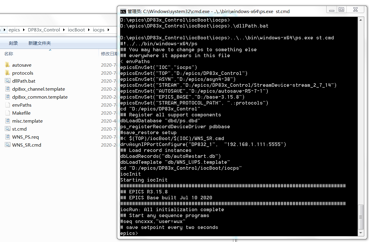

There is something wrong with what I said in my previous email. It's ture that steam 2.8.13 can be built successfully with Visual Studio 2017 and Visual Studio 2019. However, it will be aborted when the application start(when execute iocInit actually), but it can be run correctly with Stream 2.7.14. You can check the info in attachment.
I also try to compile stream with 3.14.12.8:
MSVC:2017 community
EPICS_HOST_ARCH=windows-x64
Stream 2.8.13 can be built, but the application can't be run properly. The result is the same as Stream2.8.13.PNG
EPICS_HOST_ARCH=windows-x64-mingw
Stream 2.8.13 build failedThe error info is :../ChecksumConverter.cc:777:51: error: expected ')' before 'SCNx8' Regards,
Xuan
