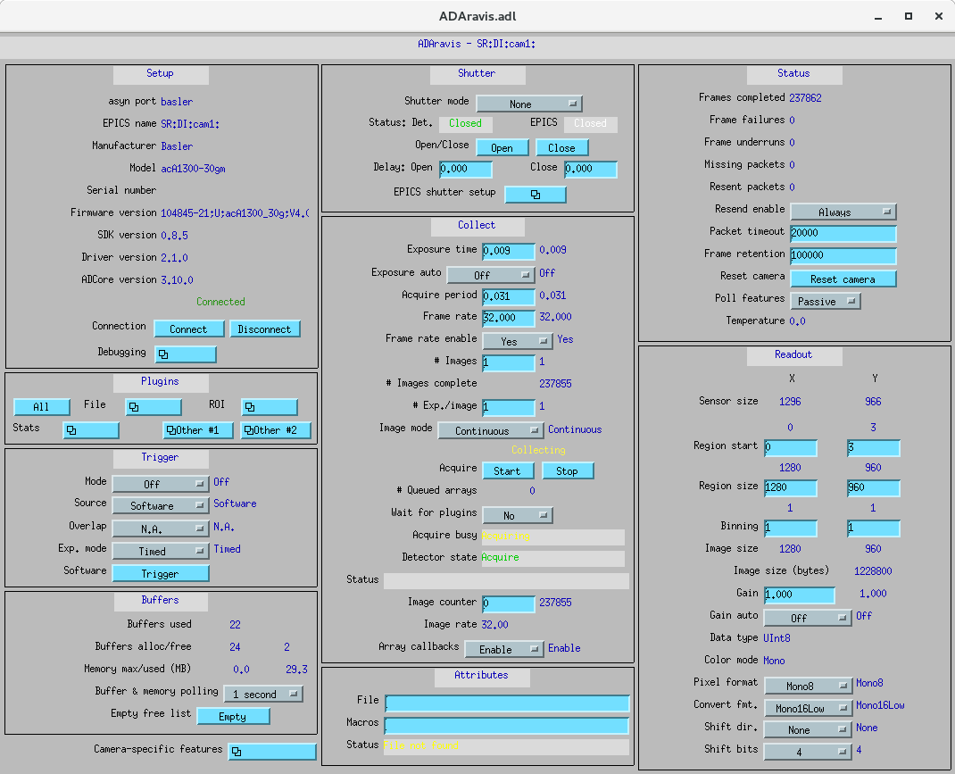

There you go.

Hi Abdalla,
You did not send the screen shot of the main ADAravis screen.  Please do that when the camera is capturing.

From: Tech-talk <[email protected]<mailto:[email protected]>> on behalf of Abdalla Ahmad via Tech-talk <[email protected]<mailto:[email protected]>>
Sent: Sunday, January 10, 2021 4:36 AM
To: [email protected]<mailto:[email protected]>
Subject: Can't enable custom frame rates for a basler camera in area detector
Hi
We tried area detector previously to control Basler cameras from Pylon and it was working. We revisited the setup again but with one problem which is we can't set specific frame rate from the ADAravis.adl GUI, frame rate enable PV value is No and does not change. The camera is running with maximum acquisition rate of 32 FPS but ImageJ viewer is seeing only 1 FPS, but If I go to NDPluginBaseFull.adl and set the max array rate it will give me the correct "frame rate". Seems the camera is running at 32 FPS but only getting one of them each second. Pylon software is working perfectly with the camera, frame rate can be enabled and set with no problems.
Best Regards,
Abdalla.
