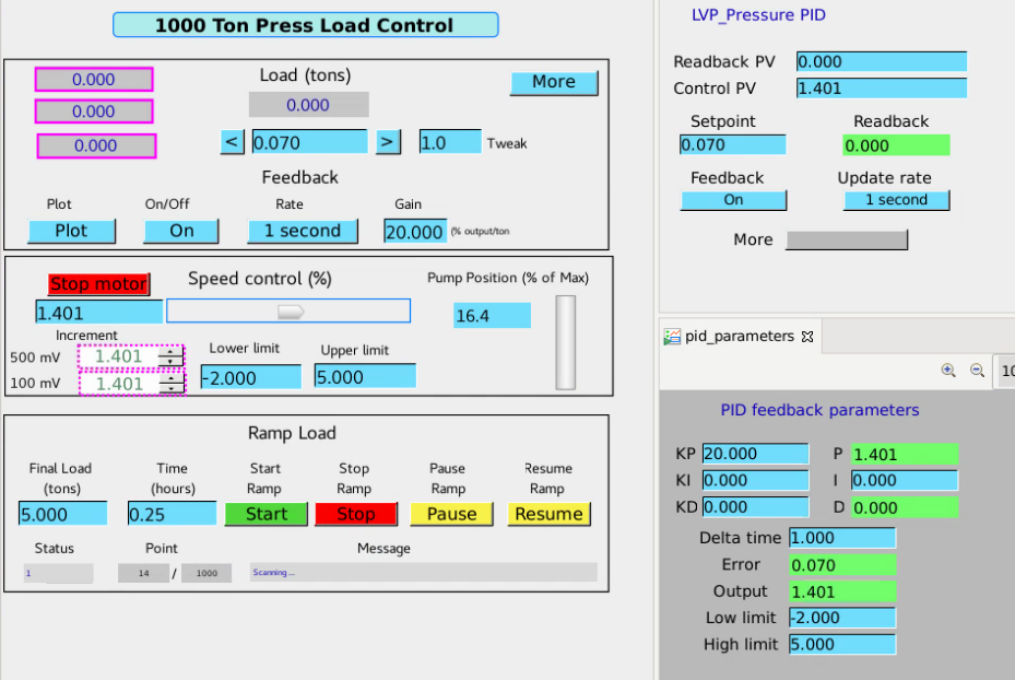

Hi Mark,
Here's the screen of the pressure control and PID.
[cid:48aa5b9d-783a-4ae2-8402-c5f6b55d7de8]
Now I see the output changing (1.401 below the Stop motor button in the screenshot).
After setting XF:28IDD-CTPress_PID.TPRO to 1, the IOC shell started to print trace information as XF:28IDD-CTPress_PID.SCAN was set to "1 second".
scan-1: dbProcess of 'XF:28IDD-CTPress_PID'
And
epics> dbpr XF:28IDD-CTPress_PID 2
ACKS: INVALID       ACKT: YES           ADEL: 0             ASG :
BKPT: 00            CVAL: 0             CVLP: 0             D   : 0
DESC:               DISA: 0             DISP: 0             DISS: NO_ALARM
DISV: 1             DP  : 0             DRVH: 5             DRVL: -2
DT  : 1.000027299   DTP : 1.000027299   DTYP: Soft Channel  EGU :
ERR : 0.21021021021021                  ERRP: 0.21021021021021
EVNT:               FBON: On            FBOP: On            FLNK: CONSTANT
FMOD: PID           HHSV: NO_ALARM      HIGH: 0             HIHI: 0
HOPR: 501           HSV : NO_ALARM      HYST: 0             I   : 0
INP : DB_LINK XF:28IDD-CTPress_Value NPP NMS                IP  : 0
KD  : 0             KI  : 0             KP  : 20            LCNT: 0
LLSV: NO_ALARM      LOLO: 0             LOPR: 0             LOW : 0
LSV : NO_ALARM      MDEL: 0             MDT : 0
NAME: XF:28IDD-CTPress_PID              NSEV: NO_ALARM      NSTA: NO_ALARM
ODEL: 0             OUTL: CA_LINK XF:28IDD-CT{ES-AO}1_11_0 PP NMS
OVAL: 4.2042042042042                   P   : 4.2042042042042
PACT: 0             PHAS: 0             PINI: NO
PP  : 4.2042042042042                   PREC: 3             PRIO: LOW
PUTF: 0             RPRO: 0             SCAN: 1 second      SDIS: CONSTANT
SEVR: NO_ALARM      SMSL: supervisory   STAT: NO_ALARM      STPL: CONSTANT
TIME: 2021-08-05 11:21:46.531743868     TPRO: 1             TRIG: CONSTANT
TSE : 0             TSEL: CONSTANT      TVAL: 0             UDF : 0
UDFS: INVALID       VAL : 0.21521521521522
Best,
Ji Li

the scan ran, $(P)$(R)PID value increased, but $(P)$(OUT) wasn't changed. Seems $(P)$(R)PID was not processed.
The fact that OUT did not change does not necessarily mean that the record did not process. Other possibilities include:
- Feedback is turned off
- The PID coefficients are such that OUT does not change
- The OUT field is being limited by DRVL or DRVH
You can set the TPRO field in the epid record to see if it is processing.
Mark

DATA: 1             DDLY: 0             DESC: Load ramp     DISA: 0
DISP: 0             DISS: NO_ALARM      DISV: 1             DPT : 0
DSTATE: POSTED      DTYP: <nil>         EVNT:               EXSC: 0
FAZE: IDLE          FFO : USE F-FLAGS   FLNK: CONSTANT      FPTS: FREEZE
KILL: 0             LCNT: 0             LPAU: GO            MPTS: 1000
NAME: XF:28IDD-CTPress_RampScan         NPTS: 1000          NSEV: NO_ALARM

RDLY: 0             REFD: 1             RPRO: 0             SCAN: Passive
SDIS: CONSTANT      SEVR: NO_ALARM      SMSG: Killing scan (kill=1/3)
STAT: NO_ALARM      T1CD: 1             T1NV: No PV         T1PV:
T2CD: 1             T2NV: No PV         T2PV:               T3CD: 1
T3NV: No PV         T3PV:               T4CD: 1             T4NV: No PV
T4PV:               TIME: <undefined>   TLAP: 00 00 00 00 00 00 00 00
TOLP: 8e 6e 6c 3b 12 c6 39 20           TPRO: 0             TSE : 0
TSEL: CONSTANT      UDF : 0             UDFS: INVALID       VAL : 0
VERS: 5.53          WAIT: 0             WCNT: 0             WTNG: 0
XSC : 0

Did you look at the screens for all 4 positioners and all 70 detectors to see if there is a disconnected PV?
Send the output of
dbpr scanrec 2
Mark

The SMSG field or the sscan record read:
Waiting for PV's to connect
And the CPT field remained 0.
The sscan record has D01PV and P1PV associated with PVs also created in this IOC, both shown as connected, readable and writable from cainfo.
Is it possible to find out what PVs, or actually something else causing this problem?
Thanks for any comments.
Ji Li
