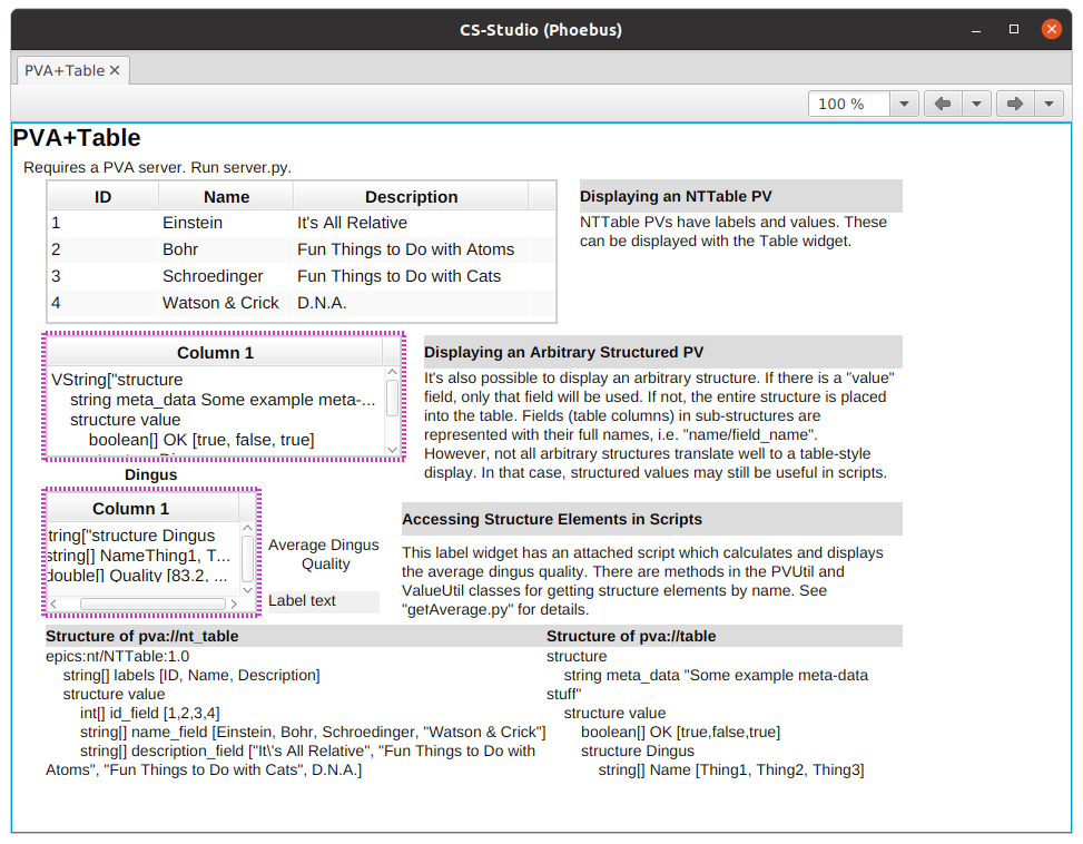

I am unable to execute ca_table_server.py located in the table folder (of Phoebus Examples)  with Python3. Can I use the pcaspy lib for python3
It works fine with python2.7
I tried another Phoebus demo code server.py at this path "Display Builder/table" located at
Here I have incorporated the dict() call as per your suggestion. Table is visible only for the first table widget.
For the remaining widgets I am seeing structure for the pva. I guess the structure is not proper.
pl find the snap attached.
Regards,
Kuldeep
