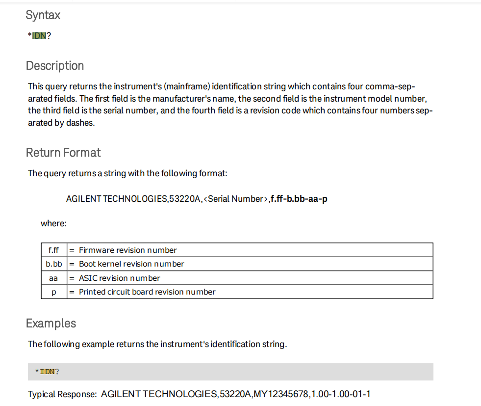

EPICS_CA_AUTO_ADDR_LIST=NO EPICS_BASE=/opt/epics/base The description of the command of *IDN? is in the attachment. I don't know what's wrong, how can I solve this problem?
Thanks, Xiaomin
