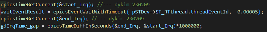

The time measurement method is as follows.
There are some questions based on the test results.
