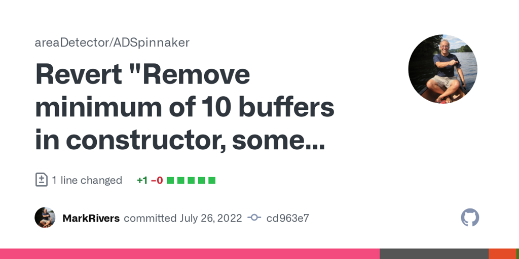

This commit reverted my previously removing that line.
What OS are you using, 32 or 64 bit, and how much RAM?

I commented out line 126 in ADSpinnaker.cpp which was liminitng it to a minimum of 10.
ADSpinnaker::ADSpinnaker(const char *portName, int cameraId, int numSPBuffers,
                         size_t maxMemory, int priority, int stackSize )
    : ADGenICam(portName, maxMemory, priority, stackSize),
    cameraId_(cameraId), numSPBuffers_(numSPBuffers), exiting_(0), pRaw_(NULL), uniqueId_(0)
    static const char *functionName = "ADSpinnaker";
    asynStatus status;
    //pasynTrace->setTraceMask(pasynUserSelf, ASYN_TRACE_ERROR | ASYN_TRACE_WARNING | ASYN_TRACEIO_DRIVER);
    if (numSPBuffers_ == 0) numSPBuffers_ = 100;
    //if (numSPBuffers_ < 10) numSPBuffers_ = 10;
    // Retrieve singleton reference to system object
    system_ = System::GetInstance();
I can now acquire it without the IOC crashing. Now I just need to verify I'm getting the correct image.
Thank you again for your help!
~Ben
