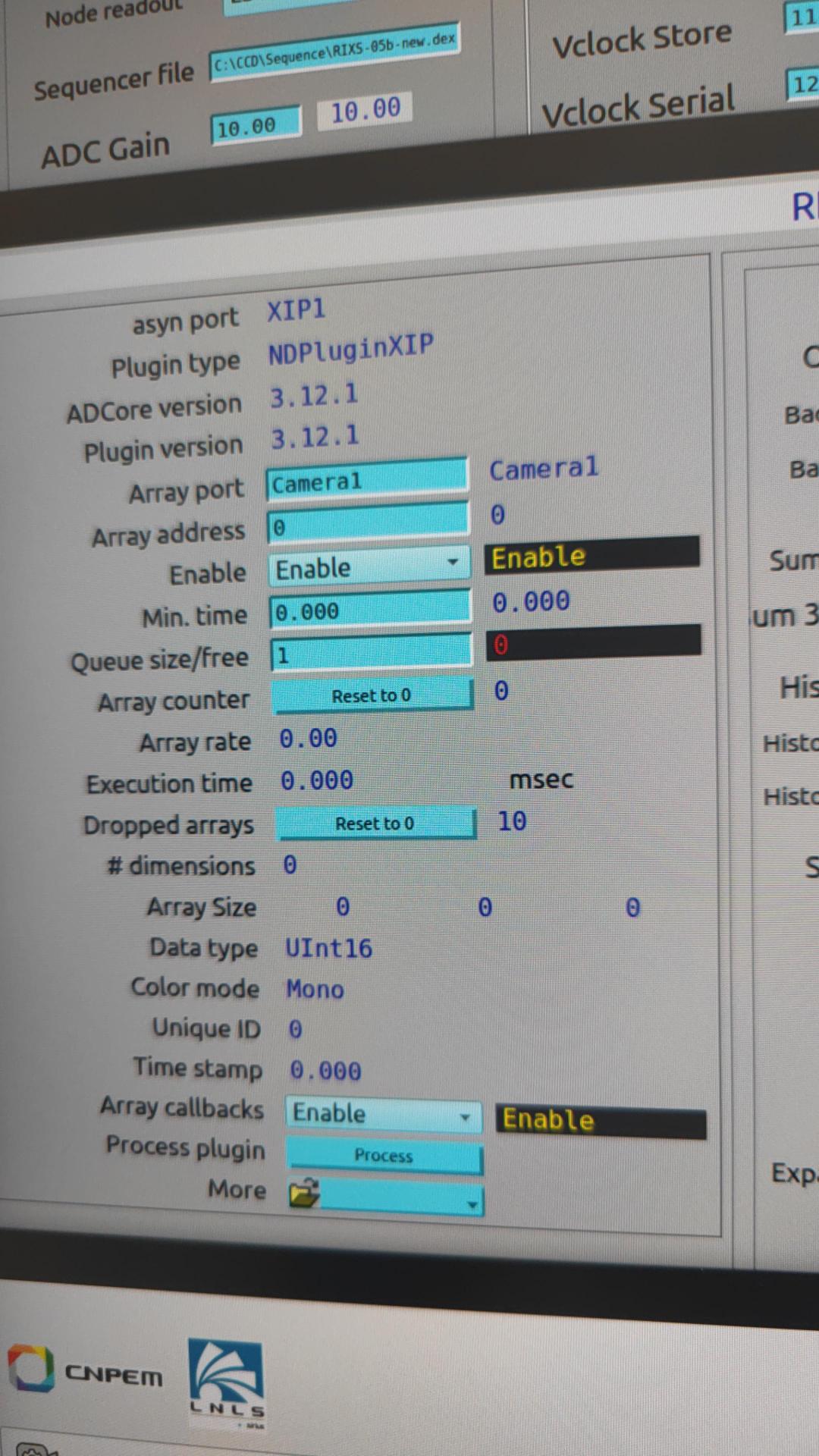

But after compiling and changing the version of ADCore, the XIP plugin has been showing strange behavior.
I think it's something related to the version of ADCore=2.2.0, it doesn't handle NDPluginDriverQueueSize and NDPluginDriverNumThreads.
In the new version of ADCore = 3.12.1, it handles these functions.

I needed to make the change in deleteCallbackThreads and createCallbackThreads, because when we raised the IOC, the shell showed: errors involving these two functions:
2023/07/11 12:00:50.994 NDPluginDriver::deleteCallbackThreads timeout waiting for plugin thread 0 exit message
2023/07/11 12:00:51.001 NDPluginDriver::writeInt32 ERROR, status=3, function=57, value=1, connectedToArrayPort_=1
2023/07/11 12:00:51.011 NDPluginXIP:writeInt32: error, status=3 function=57
2023/07/11 12:00:51.019 IPE:RIXSCam1:XIP1:NumThreads devAsynInt32::processCallbackOutput process error
I think it might be something related to the PVs

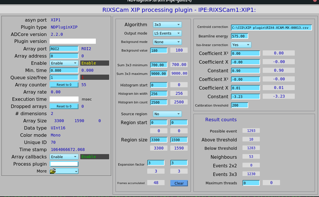

  • IPE:RIXSCam1:XIP1:QueueFree
  • IPE:RIXSCam1:XIP1:QueueSize
Because in the image with ADCore 2.2.0, the PVs IPE:RIXSCam1:XIP1:QueueSize and IPE:RIXSCam1:XIP1:QueueFree have the values ​​1 and 1 respectively. While with ADCore 3.12.1 they have the values ​​1 and 0 respectively.
Thanks.
