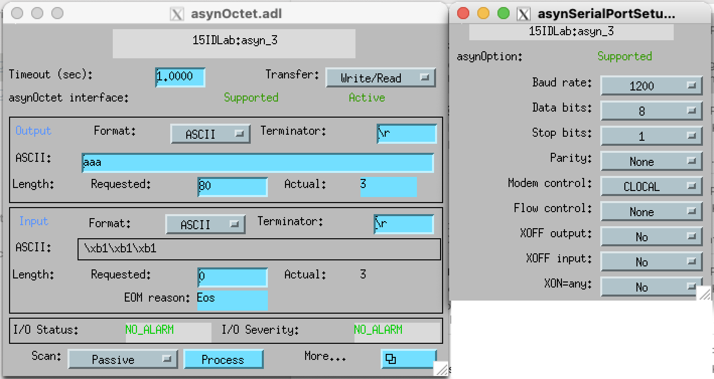

Although the RS-232 settings for Lakeshore 330 are (Baud rate:1200bps, Parity: Odd, Stop bits:1, Data bits: 7), I tried to test the loopback with your suggestions (data bits: 8, parity: none), and got different input/outputs for 1200 baud rate as shown in the attached image. With 2400 and above baud rates the input/output values are the same as expected.

1) With loopback communication(when I sorted the 2 and 3 terminals of the RS-232 ports) with the baud rates of 2400 and above, I received the same input and output values (as shown in the 1st attached image). That shows that RS-232 communication is OK.
2) With the baud rate of 1200, the Output and Input values of asyRecord are different (as shown in the 2nd attached image). I suspect either the tyGSModule or TVME-200 with IP-Octal Serial board has some issue with communication baud rates below 2400.
